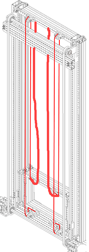

Challenge accepted :slight_smile:
To move the carriage half as fast as the second stage, just add a pulley on the carriage and fix the rope back to the top of the carriage:

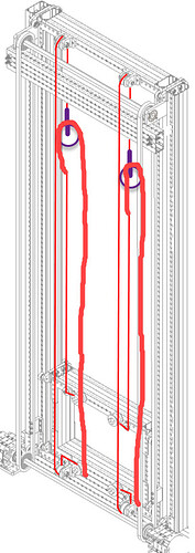

To move the carriage twice as fast as the second stage, you need to add a floating pulley. The line pulls the floating pulley up, and the rope going around the pulley is anchored to the carriage and the second stage.
Assuming you have proper tension in your system, both are fairly easy and straight forward to implement, although I don’t see much reason why you would do it in this context. In the first one, the carriage moves slower, but it means you need less force to lift it. You’ll see it in situations where you need to lift something heavy, but don’t really care about how much rope you need to pull in. The second you move faster, but you need more force to lift it. I can’t think of a situation off the top of my head where that would be particularly useful, but I’m sure it’s there somewhere!
Note that both of these arrangements change the total distance travelled for the elevator system - you won’t be able to reach as high. In the first, the carriage will only be halfway up when the second stage reaches its limit. In the second, the second stage will only be halfway up when the carriage reaches its limit.
And this was why I said there wasn’t a good way to change that rather than saying there was no way to change that. The whole context of the answer was in regard to trying to get more height out of the same size elevator. Thus I disregarded solutions that would get less height for a mechanism as not being a good way to change that. It certainly wasn’t that I didn’t know you could use mechanical advantage to change the travel ratio between carriage and second stage, it was just that these were not useful solutions in this circumstance.
