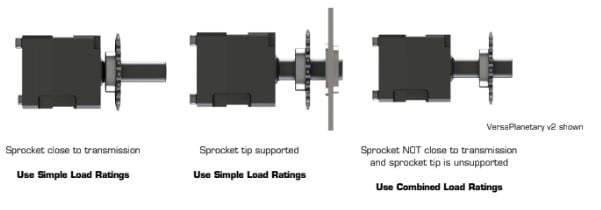

You probably have something like the 3rd gearbox, adding some support as the middle one should help.

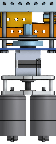

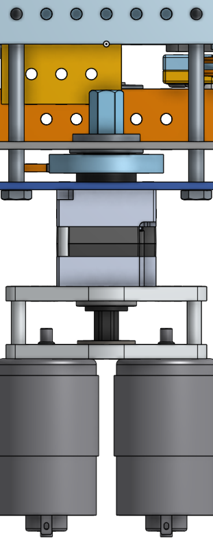

@asaphfirst Here is what our gearbox setup looks like in CAD:
Are you saying we should support the end of the shaft rather than the middle? Wouldn’t our situation still match the simple load ratings because the sprocket is close to the gearbox?

Also, based on your cad - it looks like your drive sprocket/motor is mounted via 2 long bolts. These bolts, or what they are mounted to could be flexing as well.

The bolts are 1/4" grade 8 steel bolts, I don’t think those are flexing. We will check the 2x2 beam that it’s mounted to.
