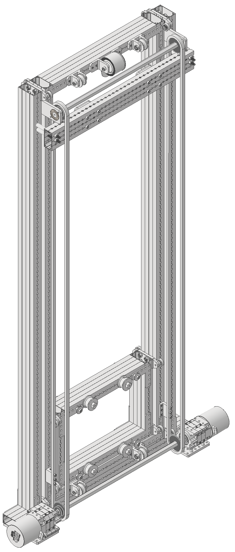

Check out the COTS elevators on the market:
The best way to get started with elevators is to adapt one of these to your design. Even though they’re kits, you still have to choose the height, width, number of stages, mounting, gearing – plus whatever method you choose to get electricity and/or pneumatics to the far end. Just assembling one in CAD is a challenging task.

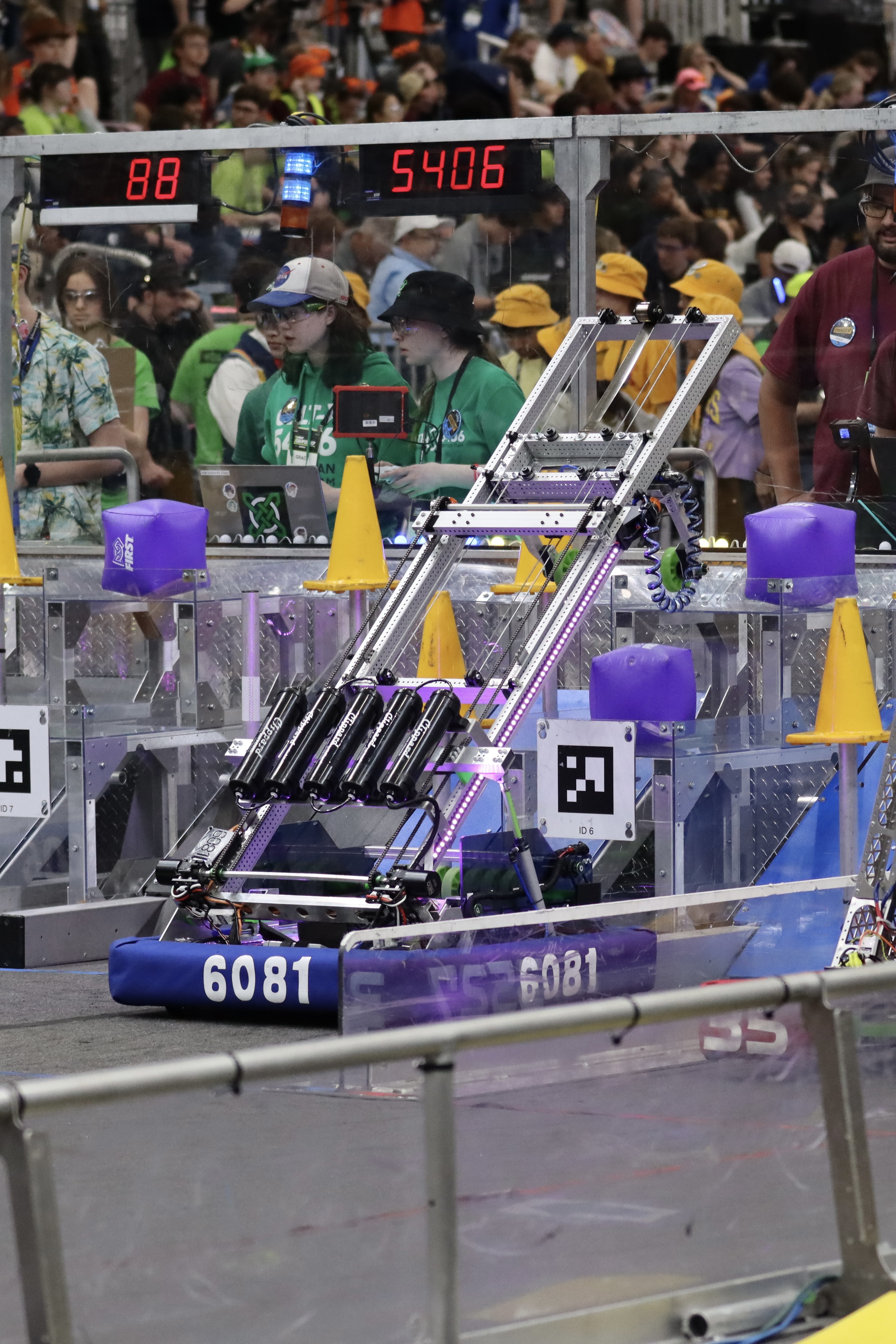

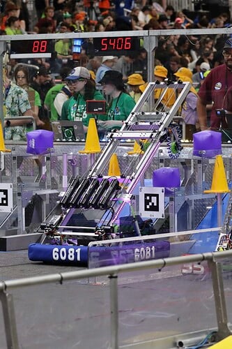

6081 uses a pneumatically actuated tilted elevator design. We decided on the Thriftybot 2 stage elevator, super fast on two neos running 3:1, and it’s relatively light when using light maxtube. We use the tilted up position to shelf load and for frame perimeter at the beginning of matches, and the down position for scoring. Simple yet effective. Our behind the bumpers goes into a bit more detail.
