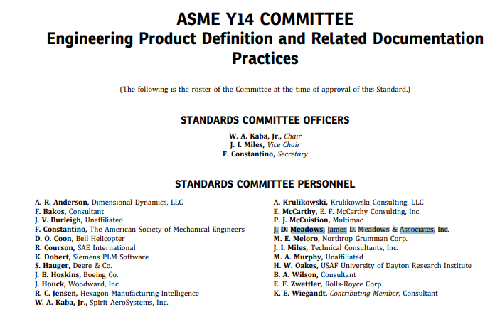

Story time: I have worked for (sadly) a couple individuals who told James Meadows, to his face, that he was creating a drawing and GD&T in correctly. Now you may be wondering ā€˜who the heck is James Meadows?’
Here he is!
Here he is again!
Yeah… they told the guy who literally wrote the book on much of the modern drawing and dimensioning practices that he was wrong. (It was a shame because he’s a super nice guy and gives his email to all of his students so you can ask him questions in the future, which I have done several times.)
Suffice it to say that they were wrong, Meadows was right, and the drawings we make at my work suck a whole lot less now after some… heated discussions.
