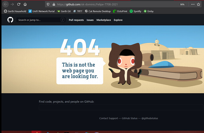

We are having similar issues, can you look at ours as well? Please
https://github.com/ok-dominic/Felipe-7708-2021.git
Hmmm, the link does not seem to work. Is your repo public?
