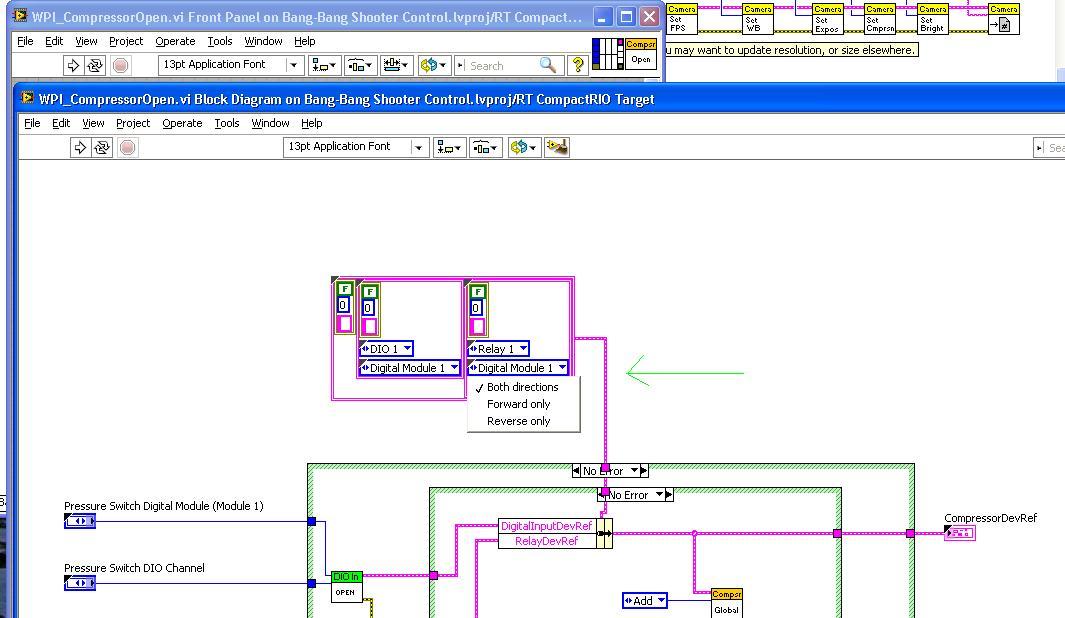

I believe what my boy Harsh, aka MrTechCenter, was trying to say was:
If you open the Compressor “Open” vi in the Begin.vi, when you go to the block diagram, you can set the “Direction” of the relay. Three choices are there: “Both directions”, “Forward only”, and “Reverse only”. Select “Forward Only”.
See the attached picture for details.
