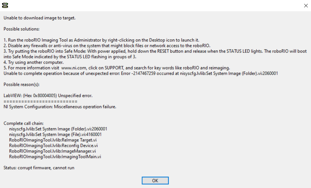

I’ve been attempting to reimage a 2020-imaged roboRIO with the new 2022 v3.0 firmware. I’m using a USB-A to USB-B cord plugged into the roboRIO and the computer. I keep gettiing an error in the middle of the reimaging process. This is the one I get most commonly:
. “Unspecified error” doesn’t tell me much about what’s happening, but here’s what I’ve tried:

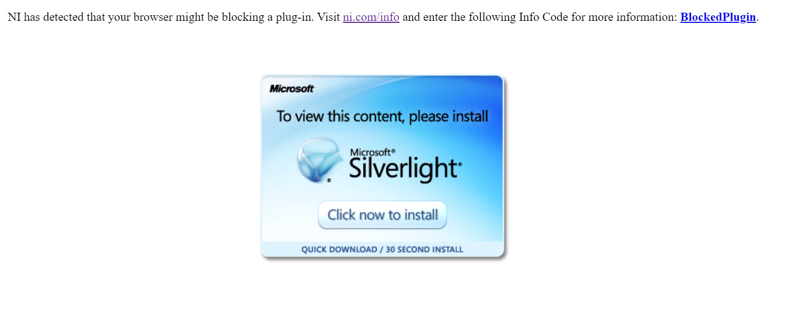

When connecting to http://172.22.11.2 in Internet Explorer, nothing shows up except a link (that doesn’t work) to download Microsoft Silverlight. In any other browser (I’ve tried Edge, Chrome, Firefox, and Vivaldi) I get this page (which is the same as that in IE except for the text at the top about a blocked plugin.
I ended up getting it working over Ethernet rather than USB — I think the usb cord may have been broken.
