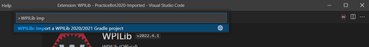

When I tried to bring it up in Visual Studio I got this error
IF I select no I get broken dependencies. Did you get a pop up like this?
If I select yes I get taken to an import page.
Then it creates a new project with a bunch of broken dependencies because some things have moved . There were several breaking changes
You should be able to fix these by importing the right packages. And a few other code changes.
But if you close your project and open it and you don’t get these you are probably not on a 2022 version of the plugin.
You can find the plugin version by going to View->Extensions and selecting the wpilib extension
If you are on the v2022.4.1 version and you don’t get the import dialog you can manually import
If you aren’t on the right plugin you will need to install the 2022 version of wpilib
