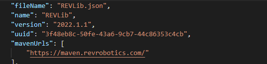

Where does it say that? All of those are 2022 thou?rev
I’m trying to get the newest version posted to github so i can link there, 1 sec
Com.revrobotics JNI loader is trying to find edu.wpi.first.wpiutil.RuntimeLoader. This class moved packages in 2022. Are you sure you don’t have a revrobotics vendor dep in addition to Revlib?
This is the current build I can working on. I only have the revlib.json in the vendordeps.
I suspect the SDS swerve library is pulling in an older Rev robotics library. Does SDS have a 2022 release?
It says it is updated. https://github.com/SwerveDriveSpecialties/swerve-lib
