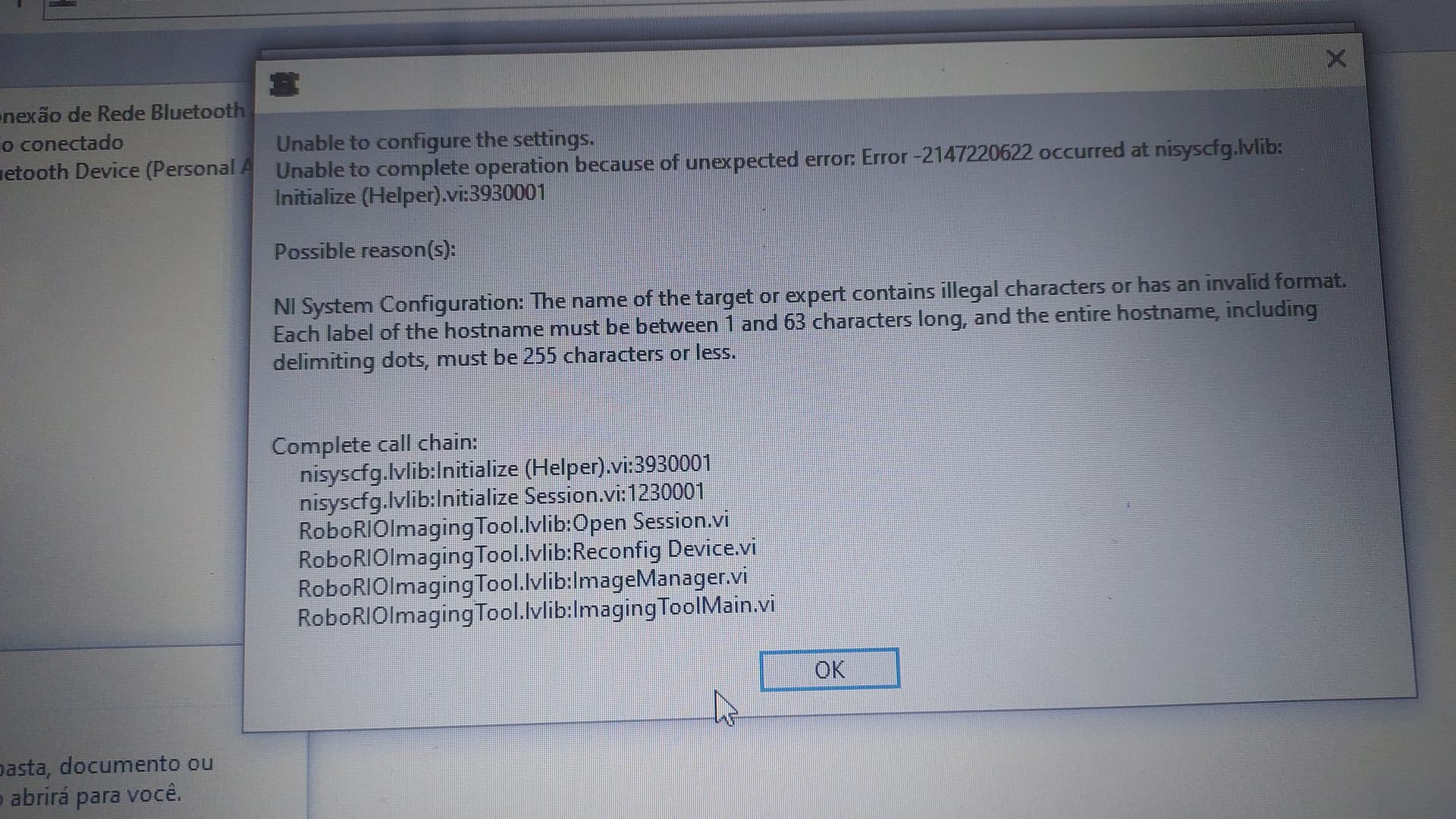

Error while reimaging the RoboRio 2.0
We got the roborio working and conecting but our drivers werent working, so we got the rio resetted, checked the cablement but then by the time to change the tem code to the image it displays a error
Can anyone please help? We are a rookie team and we are super late to the developing
Have you tried using the team number setter that’s included with the WPILib tools?
For the roboRIO 2.0 imaging is best done by removing the SD card and flashing the card. Here: Imaging your roboRIO 2 — FIRST Robotics Competition documentation are the docs related to that process.
I don’t think I’ve ever successfully flashed a rio2 from USB.
