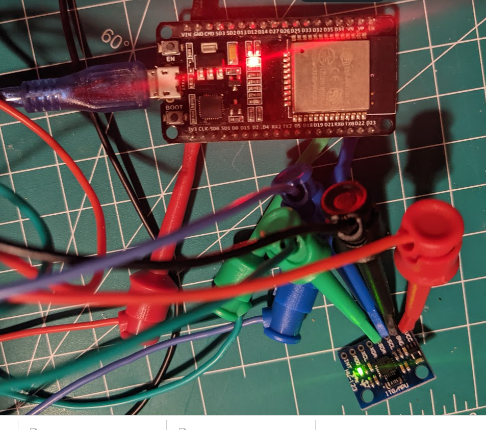

ESP32 / MPU6050 network based gyro using coap and the builtin MotionApps 6.12
Details:
ESP32 (over wifi for now, ethernet soon)
MPU6050 w 6.12 firmware
coap protocol (UDP)
msgpack data serialization
using built in MPU
Client side was a test python program.

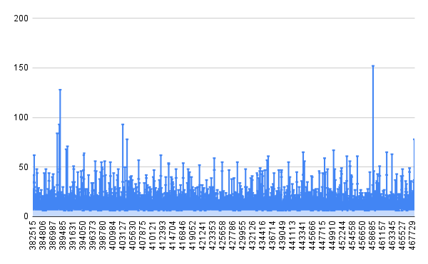

Average time to fetch and decode - 12ms
Standard deviation of yaw data : .037 degrees (sitting still)
chart (1)
Cost
$3 for MPU6050
$16 ESP32 w Ethernet (not shown)

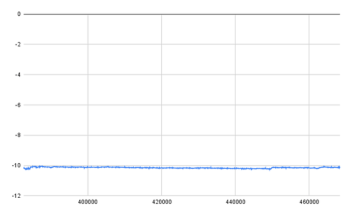

Do you have a plot of drift in yaw vs time when sitting still? Are you planning on testing this on a mobile platform?
Second plot is yaw over time. In 85 seconds the min was -10.2545291 and max was -10.04096214
