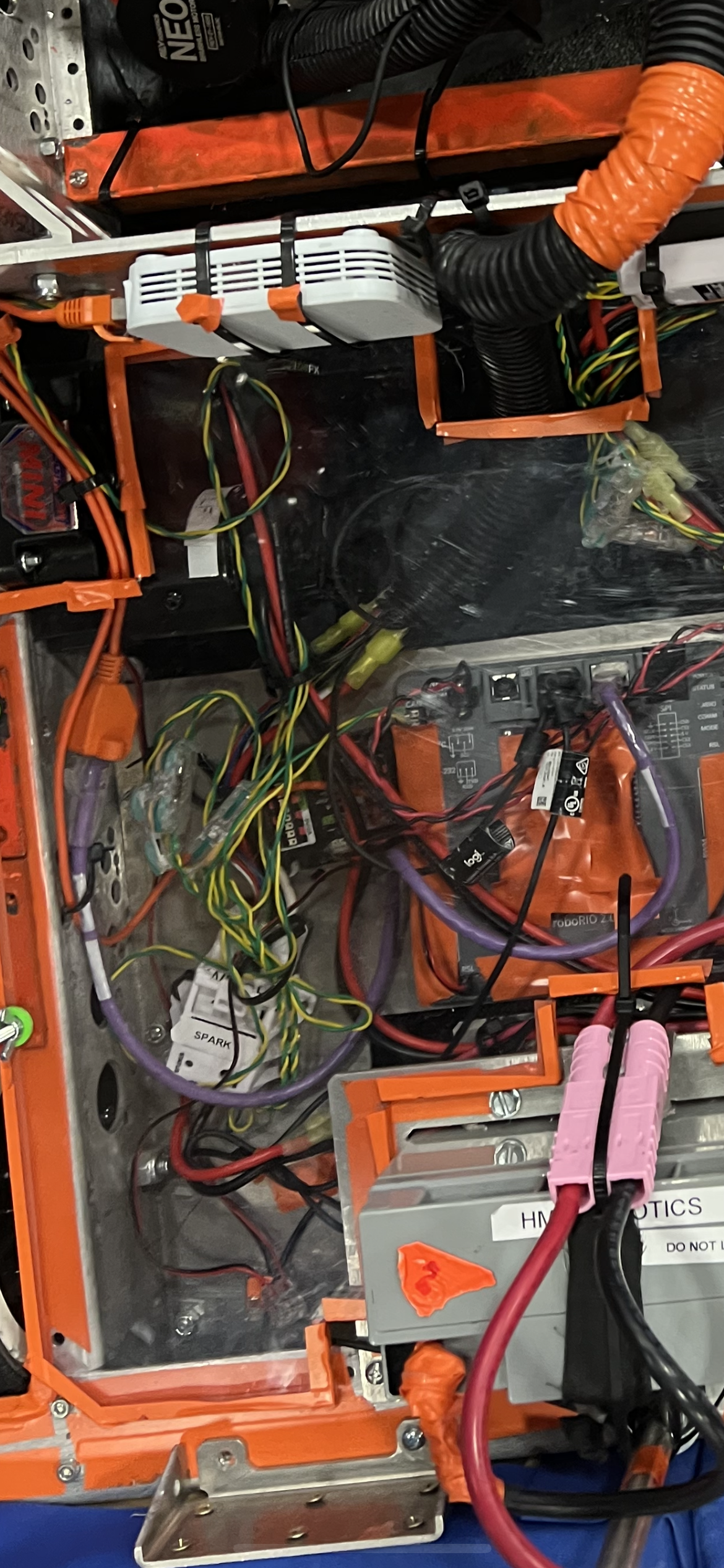

We’re having an intermittent radio to RoboRIO drop out during impacts in which the robot losses connection for ~ 5seconds. For troubleshooting we’ve replaced the Ethernet cable, improved strain relief, and added hot glue. This has improved the frequency and level of impact causing the drop, but not eliminated it.
I’ve not experienced this exact failure before and it seems unusual for an Ethernet connection to be impact / vibration sensitive. Inspecting other robots I don’t seem the same level of strain relief we’re implementing.
Any thoughts, similar experiences, and solutions that worked?
We don’t believe it’s power related as recovery from those failures requires a much longer recovery time.

A photo of your setup would be helpful.
It looks like you’re at an event, have you had a CSA take a look?

I can’t quite see here. Where is the power for the radio coming from?

You’re right in that it’s not power related, either a radio reboot or RIO reboot would take much longer. From the timing, it sounds like a contact is momentarily disconnecting during impact either at the cable to radio, cable to RIO, or cable to POE cable connection. I suspect the time delay you are seeing is the link renegotiating speed and TX/RX direction on reconnection.

Update; Hot glue masked the true issue as it came back after 1 high impact match. The team reviewed the Drivers Station logs (thanks CSA) and identified a radio connection error specifically calling out a RoboRIO fault. Replacing the RoboRIO has resolved the issue (three matches without a fault).
