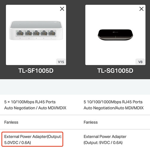

Something nice about TL-SF1005D (compared to TL-SG1005D you have in there) is the power supply voltage is 5V.

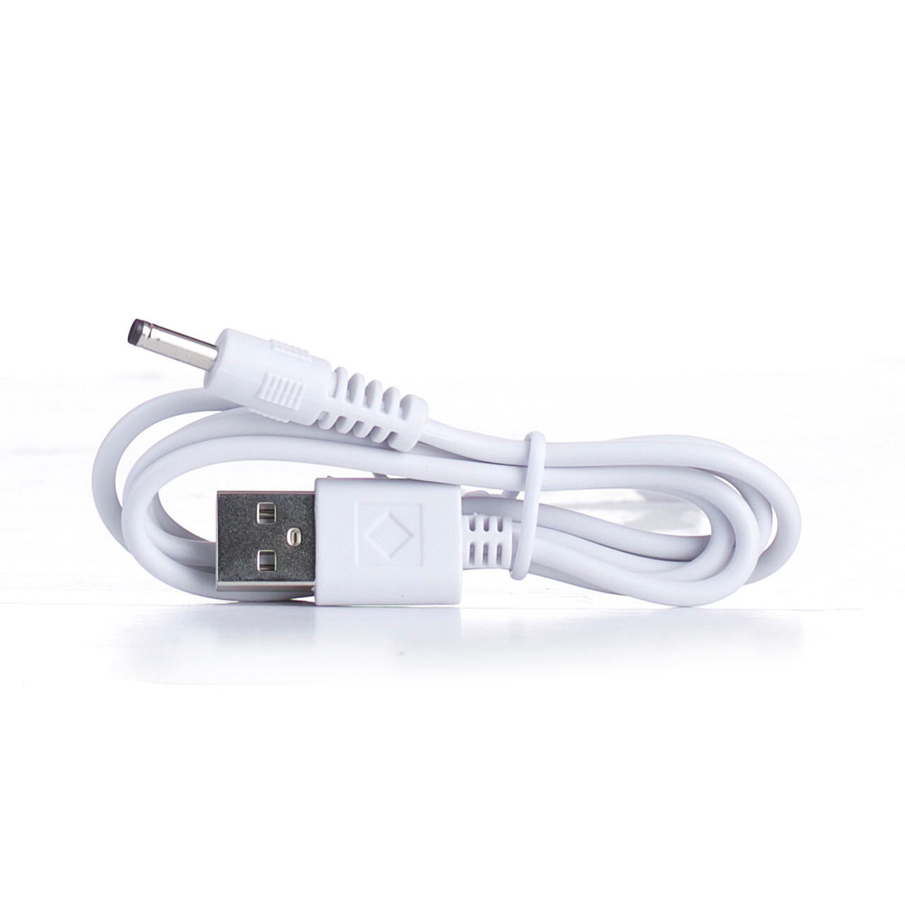

And what I’ve been doing is use a usb to barrel jack (luckily my water flosser use the same type of charging cable) and power it through one of my co-processor USB port, no extra buck converter or VRM needed. Never run into any issue with it.
