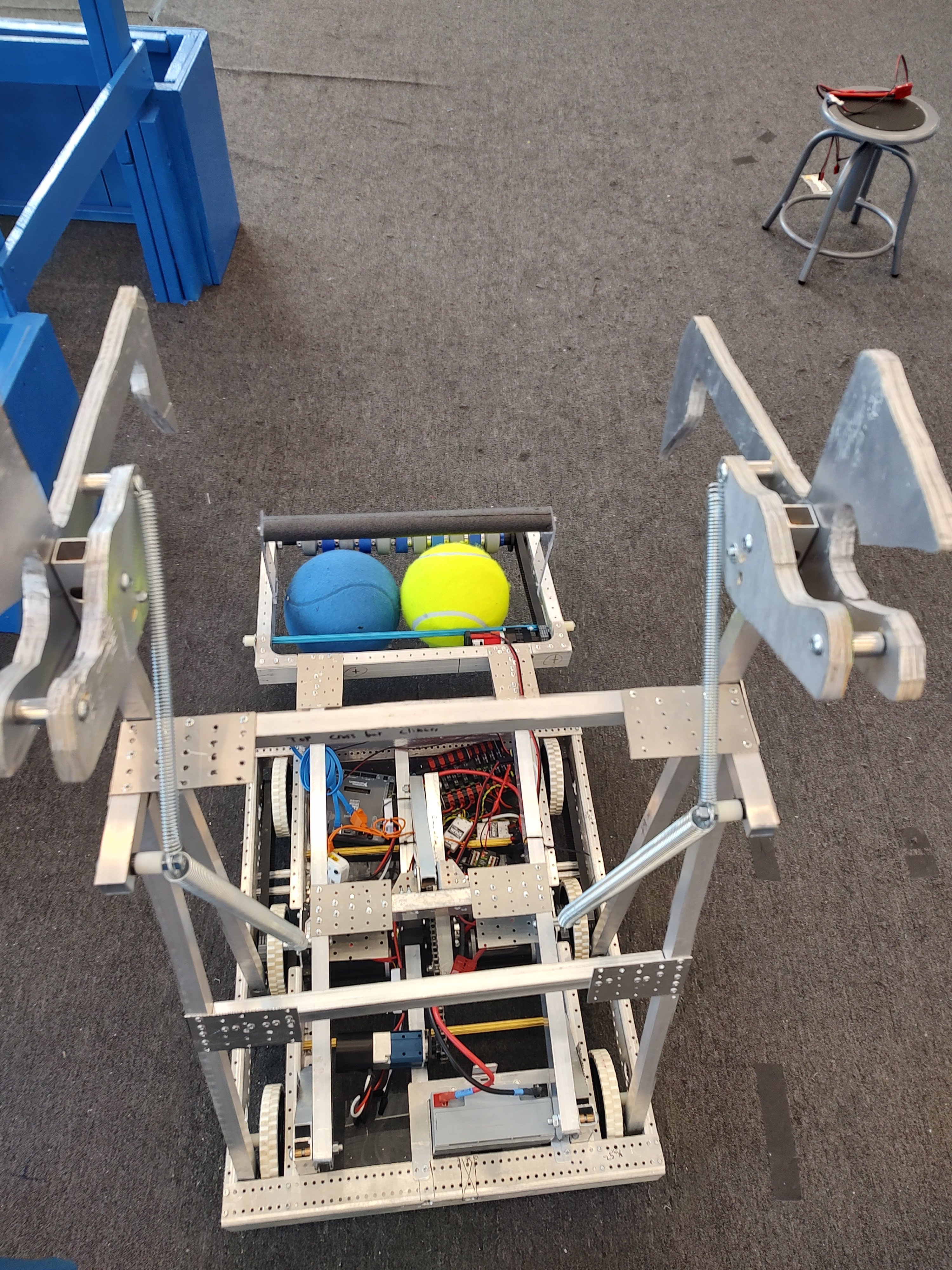

We are building the Everybot off season and followed the parts and build list diligently We have had major issues with the SPARK Max: we had followed the client hardware and online instructions/PDF, and finally had to swap them all out for new SPARK Max motor controllers to get them to respond….six days after school I will never get back. We got her driving and responding appropriately…EXCEPT the NEO. No faults showing but no movement on our intake motor to raise and lower arm…??? Ugh, does anyone have any thoughts??? Yes, we read the troubleshooting documentation, but maybe I am missing something? Any help would be massively appreciated.

Thanks so much. We had them all working when we left yesterday (without the NEO-we swapped it for a mini-CIM) but the gear box was catching, Fixed that this morning and one of the coaches updated the firmware and lost three spark maxes ugggghhhh. Re-swapped those out and now we are getting transmission errors and nothing is running in the REV client hardware…OMG. I would love some help if you can make it. I am here every school day until 5pm, but can meet up here at your convenience.
Everybot update…She is working!!! She is
quick, shoots she hangs (on second rung), but our hanger design was a little off so she could get knocked of …So a redo is underway. Did not get the NEO to run but I will try again later.
