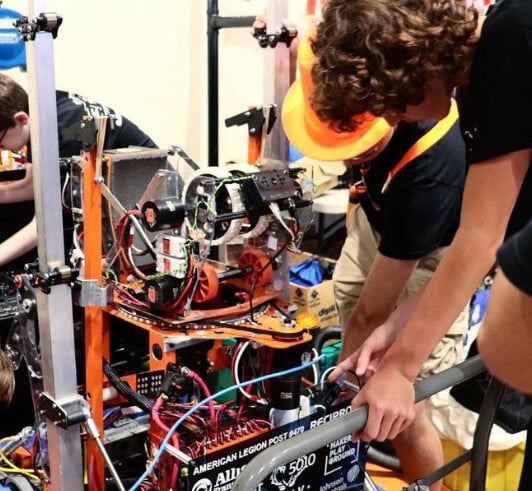

In 2022 we (2767) ran a standard brushed 550 on the turrets. Loop was tuned pretty hot (as usual). I can’t recall ratios on gearboxes off the top of my head, but I am sure they were reasonable. The biggest issue we ran into was motor overheating when we were trying to constantly track the high goal. Swapping to a Falcon solved this (although incredibly overkill in terms of power).

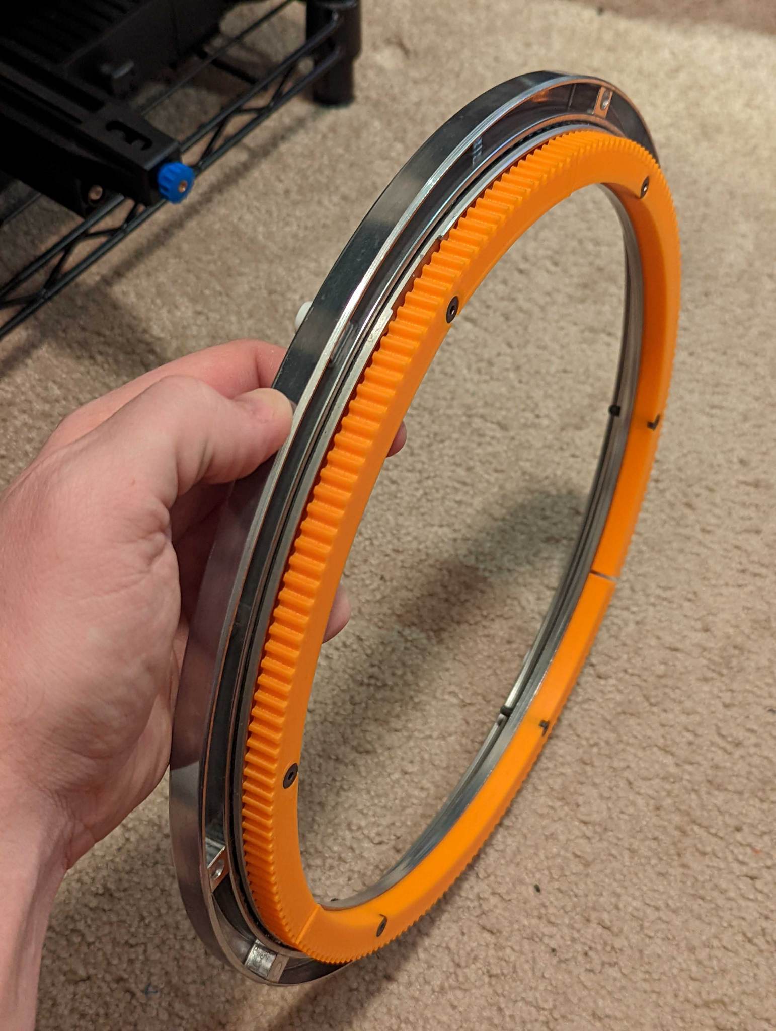

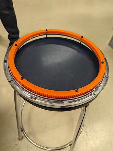

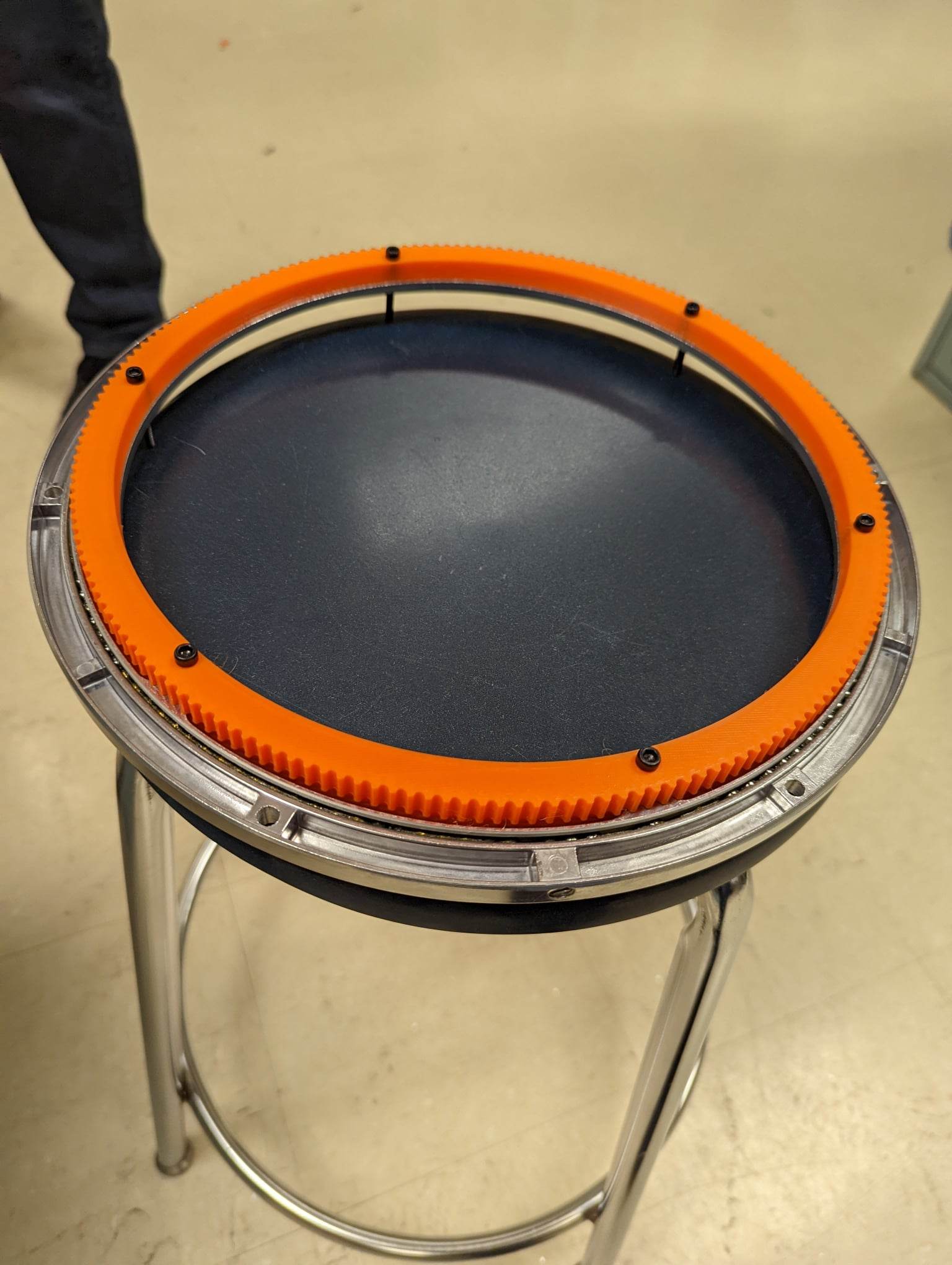

As far as the turret ring, we quite liked the large plastic (steel ball) bearings.from McMaster, backed up with sheet metal to for the turret. There was a 3D printed large bull gear, which was later swapped for a pulley and belt.

This combination of McMaster bearing and 3D printed HTD pulley mechanically worked pretty well for us in 2022 and was easy enough to assemble -
3D Printed 185 Tooth 9mm HTD Pulley Files Link

Similar to these, I’ve had good experience buying cheap amazon turntable bearings as well, then printing or routing out a custom giant gear or sprocket. They come in several sizes, which is useful.
What did you guys 3D print your gear out of? Did it ever get damaged?
Duramic PLA+ and nope, was fine all season.
Sorry to bother you once again. Do you have a picture of the turret on the robot itself? I’d like to see how it was mounted.
