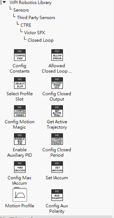

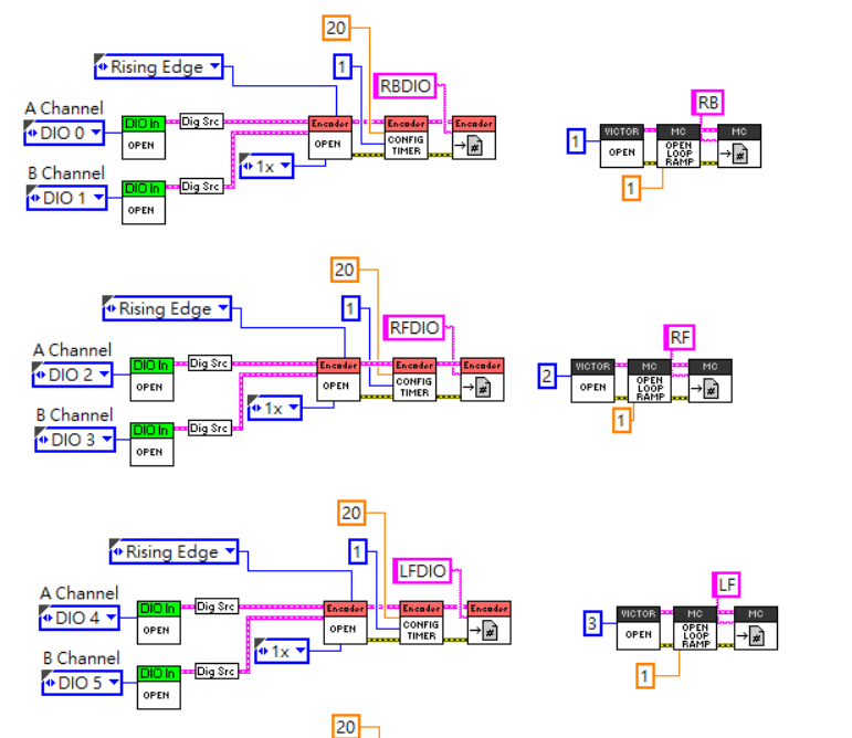

I attempted to implement PID control for a CIM motor controlled by the Victor SPX on the roboRIO. However, there is a challenge as the encoder is not a CANcoder and is connected to the roboRIO’s DIO port. I haven’t been able to locate a straightforward solution using CTRE’s built-in Closed Loop functionality.
Nonetheless, I’ve included some screenshots to provide a visual representation of our current setup. Thank you, everyone, for your assistance.

CTRE’s closed loop functionality is only for Talon motor controllers, not Victors. Victors do not support this feature.
The LabVIEW port of WPILib isn’t feature complete and doesn’t include a PID controller. LabVIEW has its own included PID controller, though I personally am not fond of it for FRC use. The unofficial WPILib LabVIEW Math library could be used, or a simple PD controller could be written (they’re not particularly complicated).

I couldn’t find any information indicating that WPILIB supports LabVIEW when I checked. Additionally, there don’t appear to be any available resources for CANIfier or CANCoder at the moment.
This isn’t supported by CTRE’s library in any language.

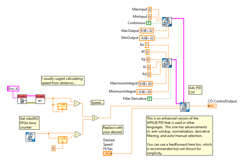

As others have said, if your encoders are connected to the roboRIO, the PID needs to be run on the roboRIO.

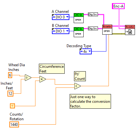

I’m a little confused by the encoder open options you chose. Generally I’d suggest:
Here is the executing code — Put in a consistent loop – in periodic tasks.
The library functions are here:

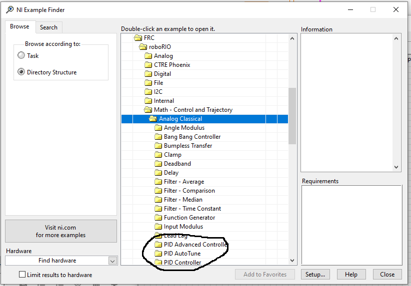

There are samples under the Help → Find Examples
