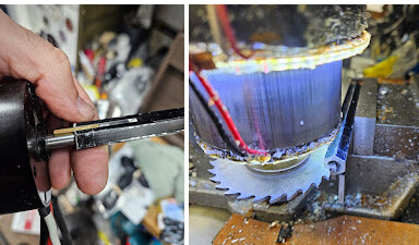

Crazy way (which I, um. Might have done…) is to drill a 2mm hole with the centerline at a 4mm radiusfrom the shaft center, drill and bore to 8mm, and then use a 2mm bar as a key.
Crazy #2 is to bore the shaft to 8mm, use a slitting saw to cut a 2mm slot into a face, and them make a custom extra-tall key to fit… done that one too…
