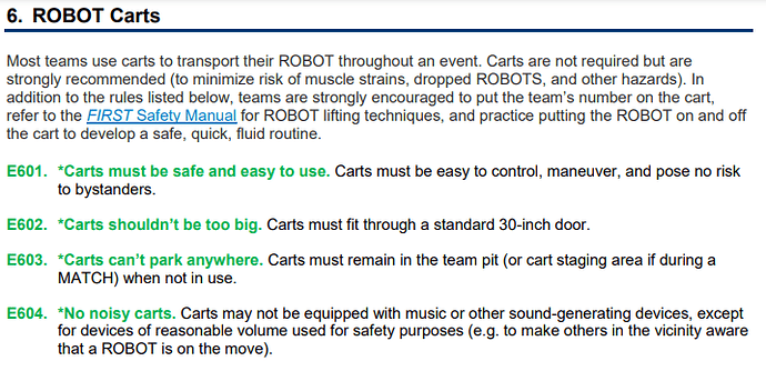

Survey past games for the maximum allowed robot height at the start of a match. Make sure that the cart can pass through a normal door with such a robot on it with some margin to account for the threshold strips that some doorways have on the floor.

Make the cart < 30" wide. This will allow it to go through a standard size door opening.

Your cart should not weigh more than 400 lbs.
Your cart should be easily movable without power and by an untrained user.
