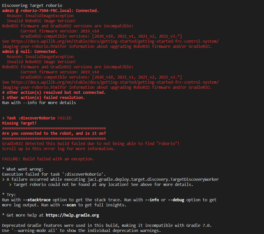

I want to update robot rio and deploy the code but I cannot connect to the robot rio
I have tried wire and WLAN to connect
did you try USB? I believe that is the recommended method for imaging the RoboRIO. Remember to select Rescan after connecting for it to try looking again.
yes, I try usb and I also try WLAN
Here is the guide to Imaging your roboRIO. Have you followed all of the troubleshooting steps at the bottom? Do you have questions about any of them?
