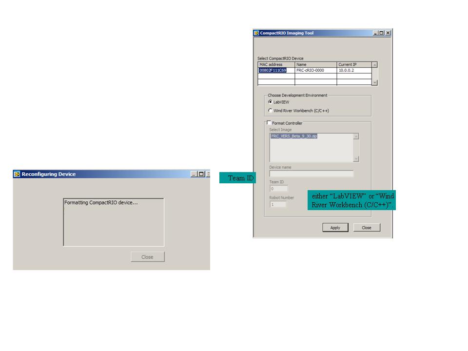

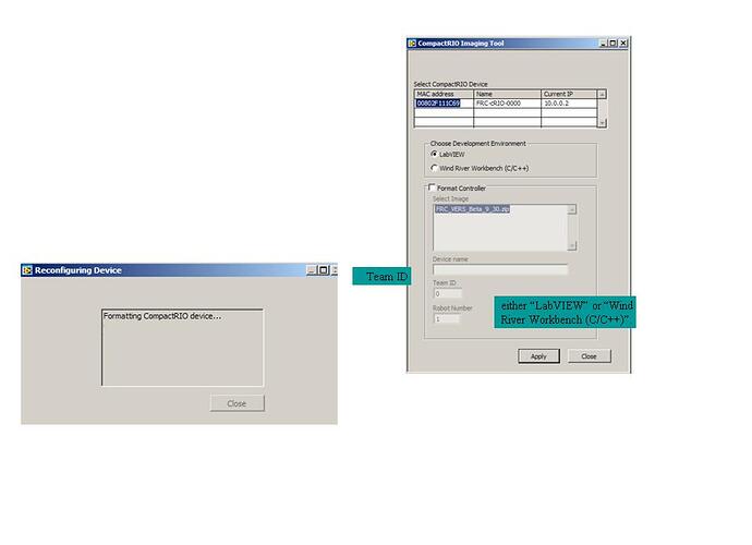

I had this problem befor if you have ane old code in the cRio
I fix this by :
install an upgraded cRIO image, follow theinstructions below:
- Start the cRIO Imaging tool by clicking on “Start
-> All Programs -> National Instruments -> LabVIEW 8.6 -> FRC cRIO Imaging Tool” in the Windows Start Menu.
If a dialog window appears with the message “No CompactRIO devices were found. Verify the network connection,” there was aA “Reconfiguring Device” window should
appear showing current status of the imaging procedure. The text window will sequence through the following messages:
a. Extracting CompactRIO Image…
b. Connecting to CompactRIO device…
c. Formatting CompactRIO device…
d. Assigning IP address…
e. Updating CompactRIO Image…
f. Configuring secondary Ethernet port…
**. The imaging process should complete
