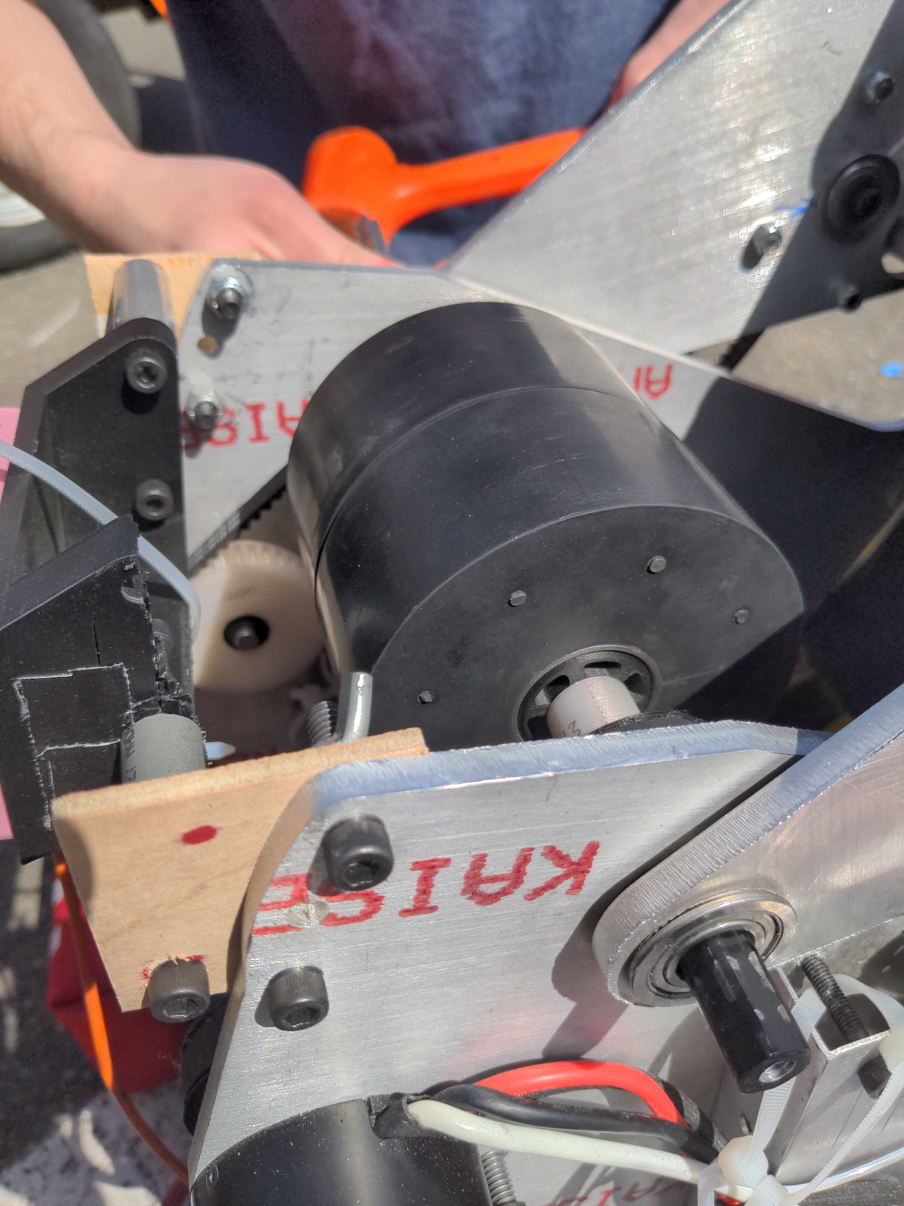

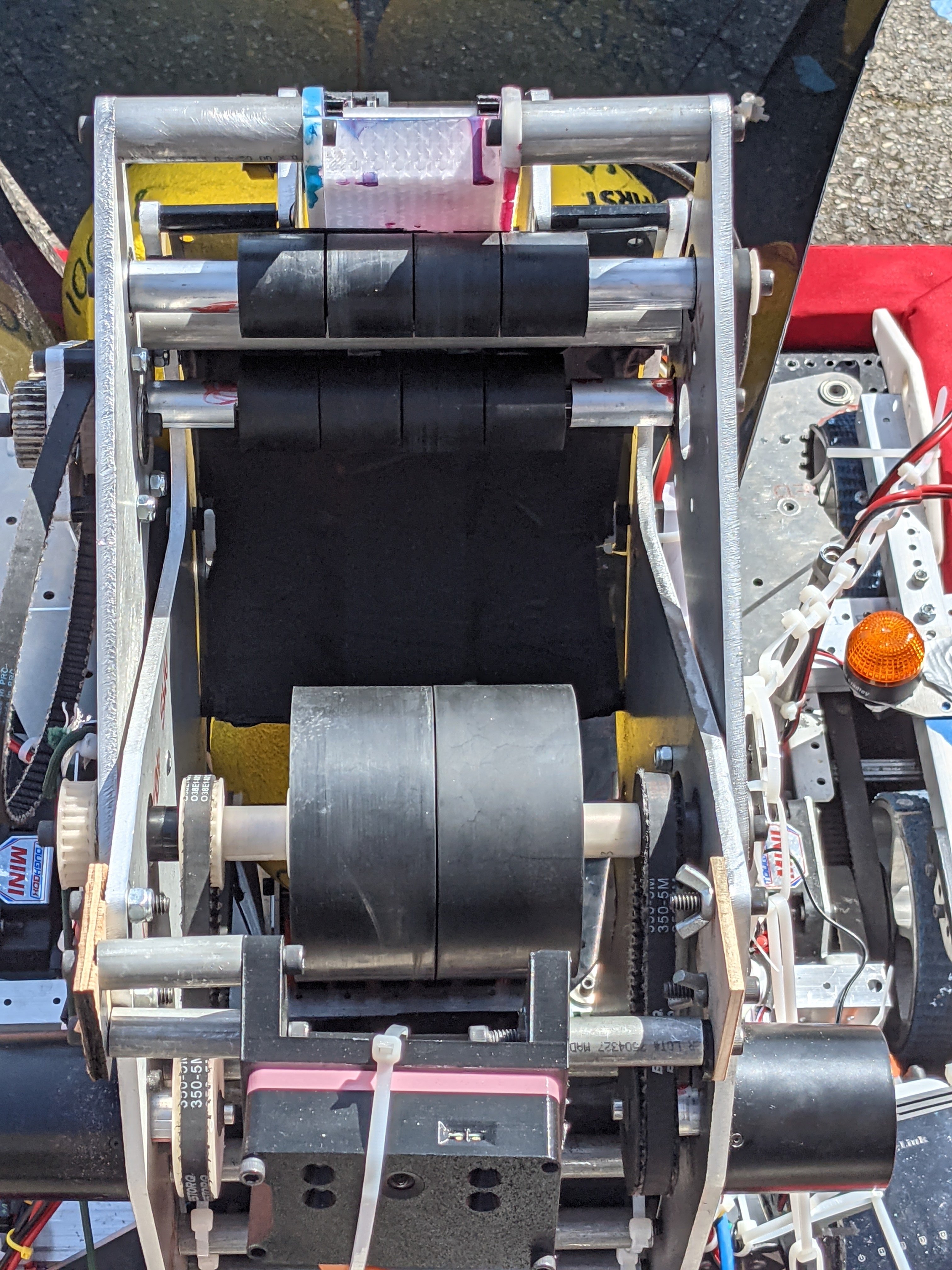

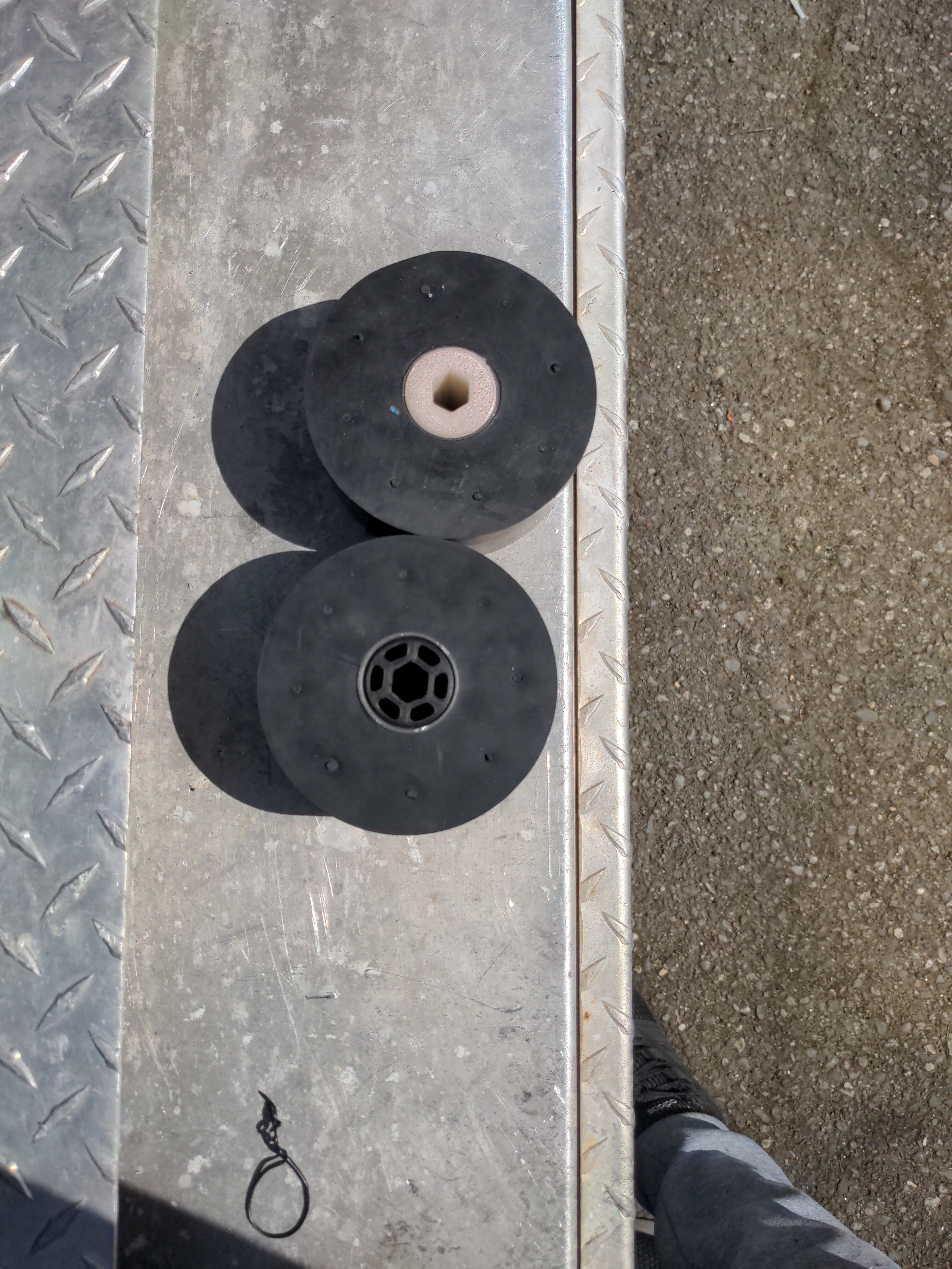

So, our team is using 4" 60a neoprene fairlane wheels for our shooter, and we’ve had two wheels fail via the same failure mode, and we’re unsure why. They appear to develop a small radial crack, and part of the wheel appears to delaminate from the hub(we can pull it off slightly). The first one had an issue due to our camera mount coming loose (causing it to dig in and wear it excessively), and we thought that was the culprit, but the replacement wheel had no such issue or wear but failed similarly, so we don’t know what’s up. Any ideas? (Initially running at 7500 rpm, dropped it to around 6000 for the replacement wheel). One of the wheels is a slip fit and wiggles a bit on the shaft, so could that be causing issues? Our shooter also vibrates a fair bit, which is probably related? Idk
(Both failed wheels)
(Shooter photos)

The WCP 60A wheels are urethane, they are closer to the blue/green urethane McMaster wheels than the black neoprene ones. We’ve ben running our WCP 60A wheels above 6000RPM most of the time with our 2020 robot and never had issues.
The black neoprene wheels from McMaster have been known to delaminate from the hub above 4000-5000 rpm due to the rubber expansion (See this post from Devin on 1678). 1678 counteracted this in 2016 by wrapping safety wire around them to prevent expansion. Devin has a demo video of how to do this later down.
Do note fairlane does make a urethane option.
But given how they are bonded to the core high rpms does concern me.

Thanks for all of the great responses in here! We got our issues sorted by lowering the rpms, and are likely going to be switching shooter material/durometer soon. We’re not sure whether to go with 60a urethane, 80a urethane, 80a neoprene, or 80a nitrile, and were wondering if there were any destructive tests done on the latter 3 to see whether they’d hold up at high shooter RPMs (can’t find any on CD). Does anyone have any insights or relevant experience?
We ran the 60a urethane solid roller wheel from WCP (2 of them) on our shooter at about 7k RPM with no safety wire or anything with no issues.
For future reference, I would recommend using the WCP 60a solid wheels when pushing RPMs. Many teams have had success with it, but something about wrapping a steel wire around a wheel spinning at +5k rpm with a history of delaminating from the hub makes me very uncomfortable. if it’s really necessary, I’d probably use something like a synthetic string that won’t turn into a needle flying at 71.4 mph (114.9 kph for those of you who don’t live in Myanmar) inevitably towards our safety captain knowing our luck.
Yeah, that’s also why we don’t want to have to run safety wire. Wcp’s wheels have been backordered since last February (2020) when we ordered them though, so fairlanes are our only real option, tho they should be functionally equivalent
