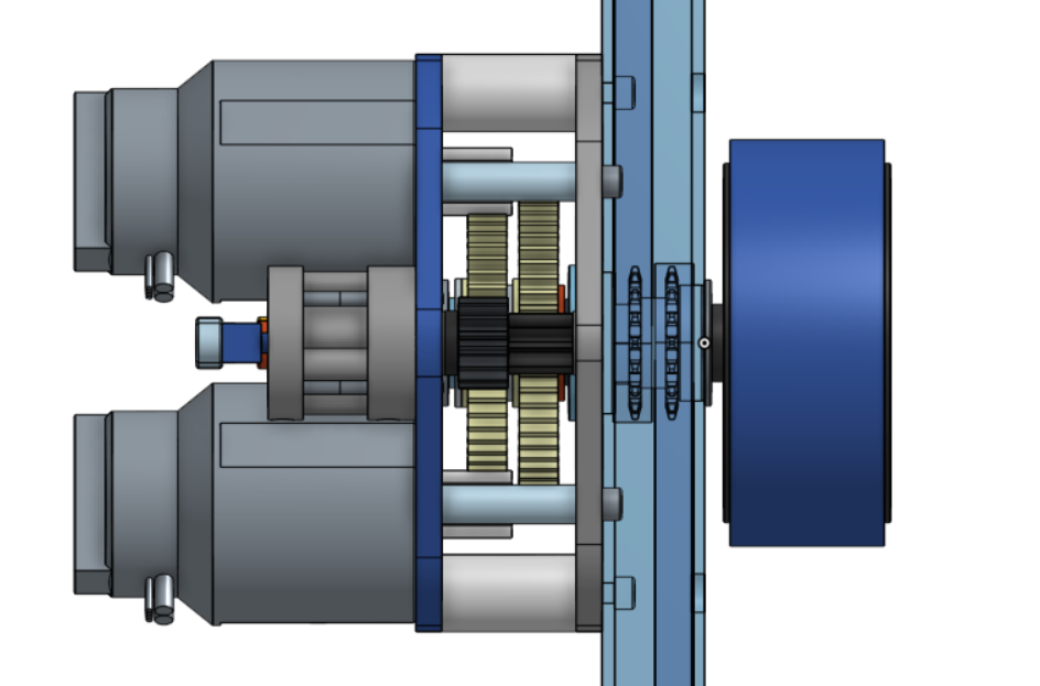

Sharing a design for a 1.5 stage shifting gearbox. It uses Falcons, but it could easily use NEOs or CIMs. Inspiration came from revisiting Patrick W’s 1-Stage Shifter from 2017. Also many thanks to @PatrickW for design input, this gearbox is more of a collab than my own design. I think it turned out pretty sweet!
More images here: https://imgur.com/a/91q0Qqi
Click here for Onshape CAD
Specs:
  • 1.98 Shifter Spread
  • High Gear is 10:54 (JVN adjusted speed of 16.7 fps with Falcons)
  • Low Gear is 10:16, 9:60 (JVN adjusted speed of 8.5 fps with Falcons)
  • Weight of gearbox, pneumatic and motors <4lbs (I don’t have 100% accurate weights on all the shifter components)
Current version shown is Chain In Tube, first version had chain on the outside. There’s also some earlier 3 motor versions that use normal pneumatic cylinders.

Wow, it took me a minute or two to figure out what was going on here. Very cool concept, and incredibly compact. Has anyone here actuated the shifter with a cantilevered bar like that before? I know I’ve seen it done with one piston on each side.
Also, here’s a cross section for anyone else struggling to see how this works.
Oops, I meant to include a cross section in the imgur album. Thanks for grabbing it. One of the really clever bits about using the cluster shaft to put a ratio between the two ball shifter gears is it totally solves any issues with gear clocking.
The best way to describe it is both motors directly drive the 54T ball shifter only. In low gear, the 54T gear is just acting as an idler between the motors and the 16T gear on the cluster shaft.

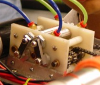

The 33 Killer Bees 2004 4-speed transmission used a similar connecting rod on both shifting shafts (#throwback). The original whitepaper link is broken, but here’s a photo from 971’s copy in 2006 (That robot had a lot of problems, but shifting wasn’t one of them).

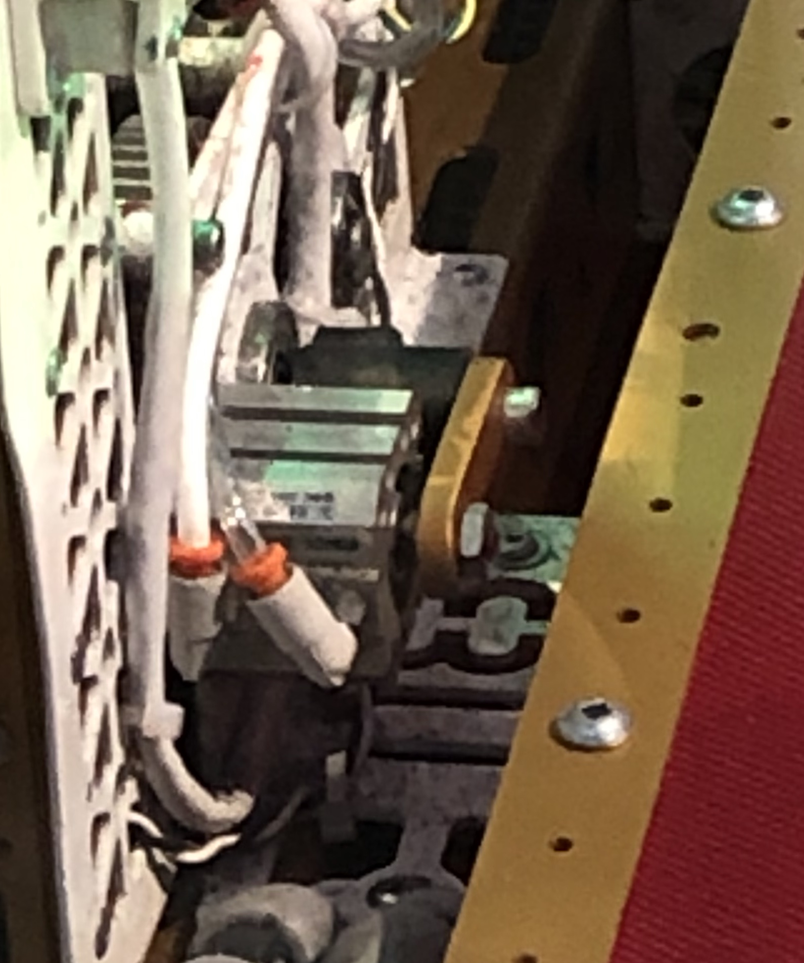

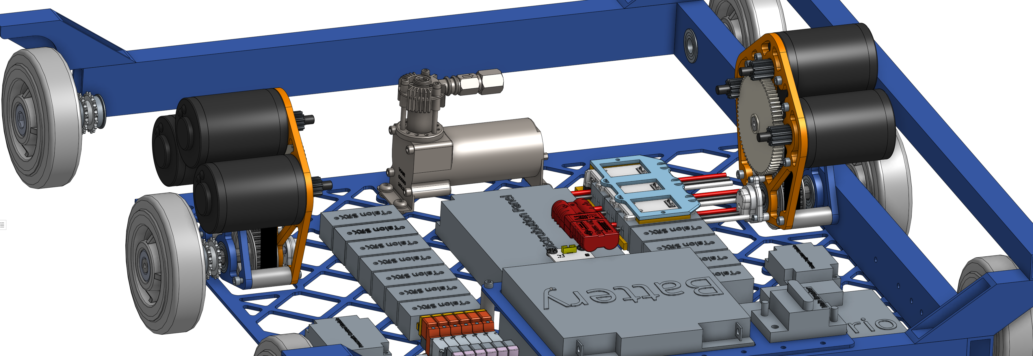

I was actually looking for info on this to try it with the NEO between wheel ballshifting gearbox, and happened to find my conceptualized setup on 118’s bot this year.
Additionally, I see a very large problem in the cross section. You’ll find that gearbox is actually only a single speed box…
how?
I see it too. That screw just needs to be 0.5” longer and it’s good.
Shifter Pneumatic position is opposite the shifter shaft plunger, so it won’t ever move. It’s a CAD error, Patrick is right that if you make the screw that attaches to the plunger 1/2” longer that fixes it. I’ll update the CAD later tonight.

Just from the pictures above, I have a few minor structural concerns that I think could be easily remedied.
  1. The bearings on the small cluster shaft seem very small to me. Maybe they would be fine, but I dont see a reason they need to be so small.
  2. Looks like only two bolts to attach the gearbox to the frame. You might want more.
  3. I would be slightly concerned about the double sprocket having a large counterbore you could face down the end of the vex shaft instead.
Thanks Bryce, great input!
You could definitely make the bearings bigger in this version. They were sized based off of the 3 motor version. They are the same size bearings that go on the Falcon shaft so I’m not too concerned about it. Extra bolts is probably a good idea.
I personally would run the chain outside the tube and not bother with modifying either the sprocket or the ball shifter output since I like having access to my chains, but it looks pretty in CAD and it’s a popular option. Facing down the shaft is certainly feasible.
