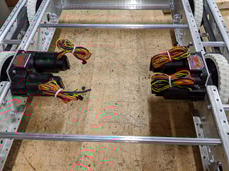

My team is ordering 4 Falcon 500 to use with the chassis we received in the kit of parts. Pretty much all we were planning on doing is replacing the CIMs with the Falcons. Would there be any potential issues with this? Is this possible? Also, what wheels would be ideal to use with this setup?
You’ll need to use a Falcon bore pinion from either VEX or AM. Other than that, this should be pretty straight forward swap.
You can also purchase 8mm keyed shafts here and use your old pinions if that’s easier.
One hiccup is that the Falcon can only accept 1/4" of thread from the mounting screws. This means you can’t use the screws that come with the KOP. That’s why we put together this “upgrade kit” with all the hardware you need.
We installed Falcons on the KOP Chassis yesterday using the ThriftyBot replacement shafts and shorter 10-32 socket head cap screws. So far, so good!
