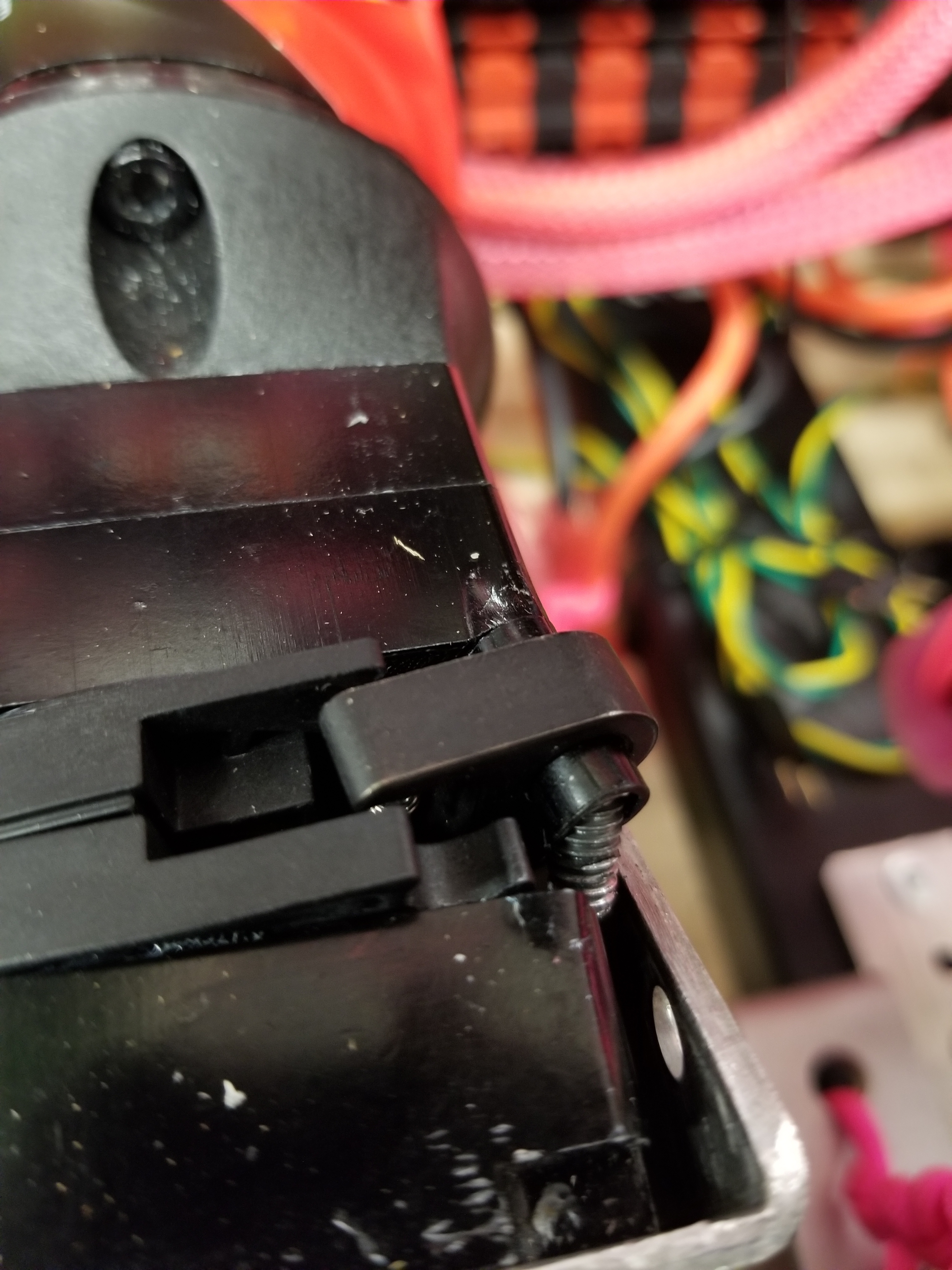

From what I see, the ratchet is not the first stage after the motor, prior to any reduction. That is always preferable so that there is the least force possible on the ratchet, and is probably the root cause of this issue.

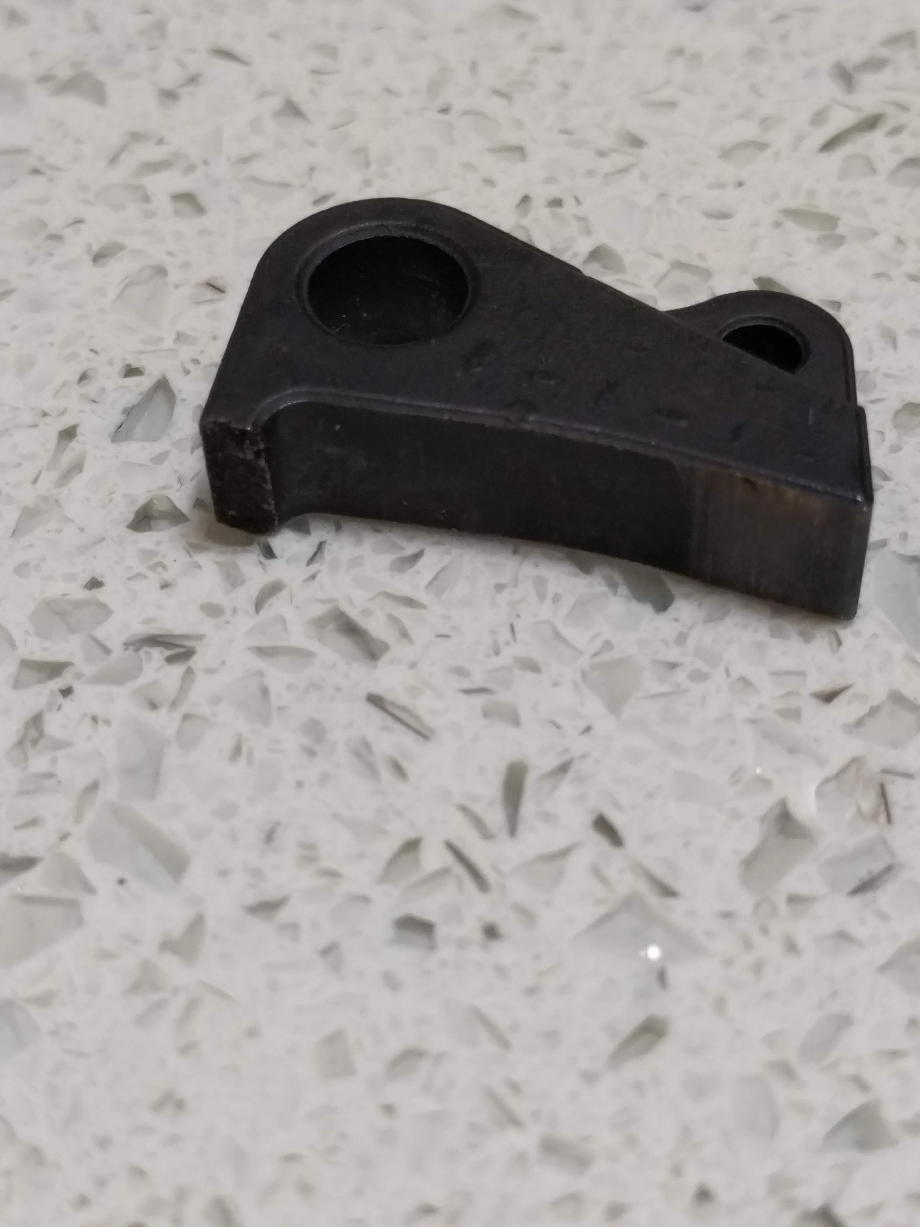

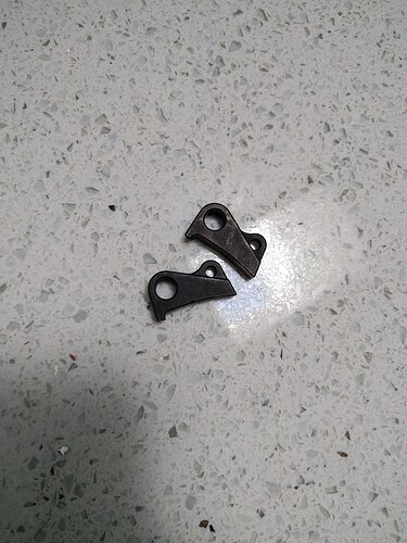

Not trying to derail the thread, but does there happen to be any rating on rpm when using the versa ratchet? In 2018 on our fork winch we had a ratchet slice on the first stage of our 775 reduction (to lower the load on the ratchet) and experienced a lot of broken ratch pawls. We never ended up pursing this failure mode as we found the gearbox was geared high enough to not back drive very much, but maybe you can shine some light on this.
Broken pawls:
