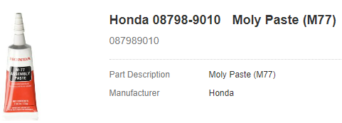

We only ran a few V3 Falcons this year, and reused several V1 and V2 motors, but here’s our only quick recommendation for V3 shafts
“Back in the day”, the spline between the final drive and the rear wheel in Honda Goldwing motorcycles would eat itself without the proper spline lubricant. This is the stuff:

One thing we did for ours was keep pinions as close to the case/boss as possible to avoid cantilevered loads. That plus the spline grease worked well so far, even for our swerve.
