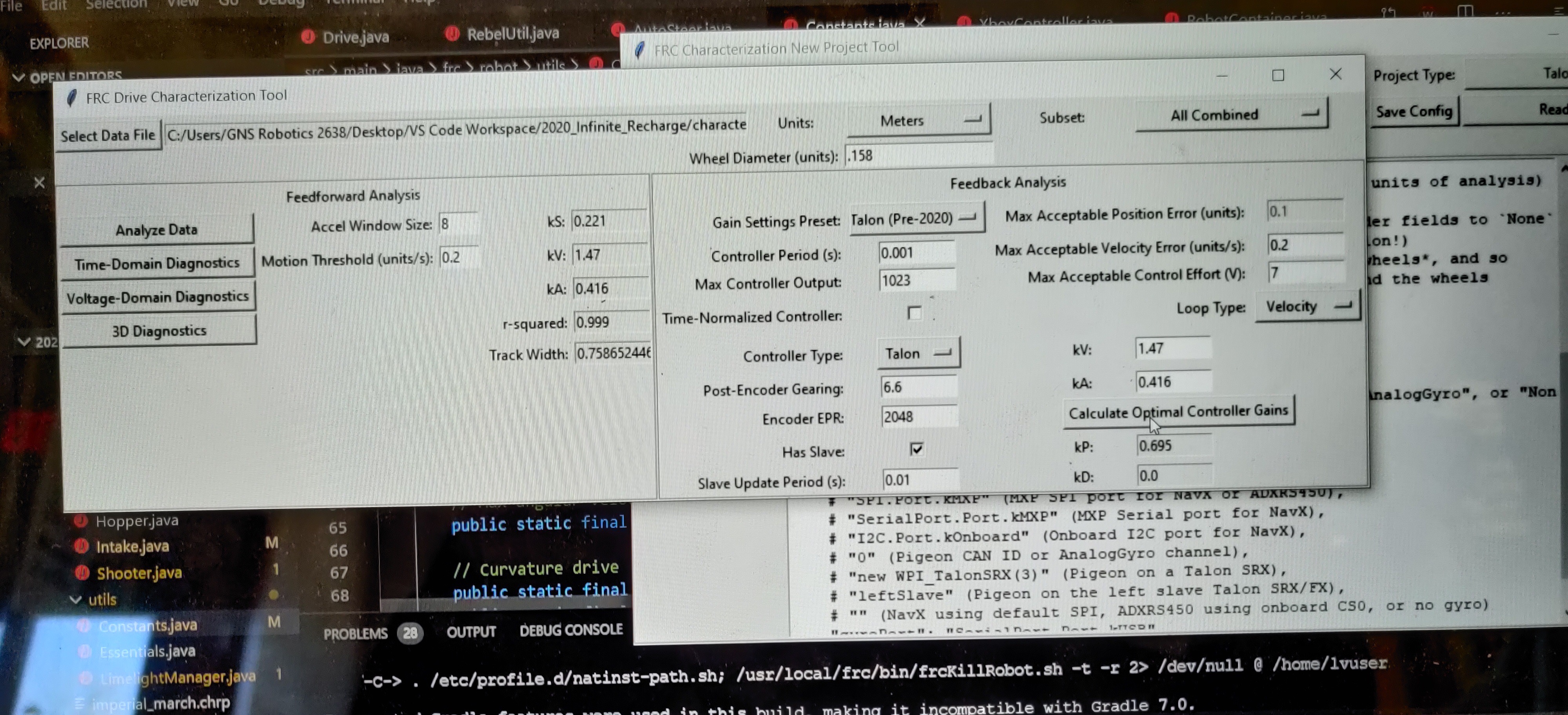

Hello ChiefDelphi, struggling team here. We are having troubles characterizing our drivetrain and using Pathweaver. After issues with the robot spinning in circles during the quasistatic tests (which we fixed by changing inversions both to true???), our data looked like the following.
When we plugged these numbers into our feed forward velocity closed loop system, our motors in short, spazzed out.

Leave the gain settings preset to wpilib and controller type to onboard. Re-read the trajectory following tutorial on wpilib to make sure you don’t have any other issues.
