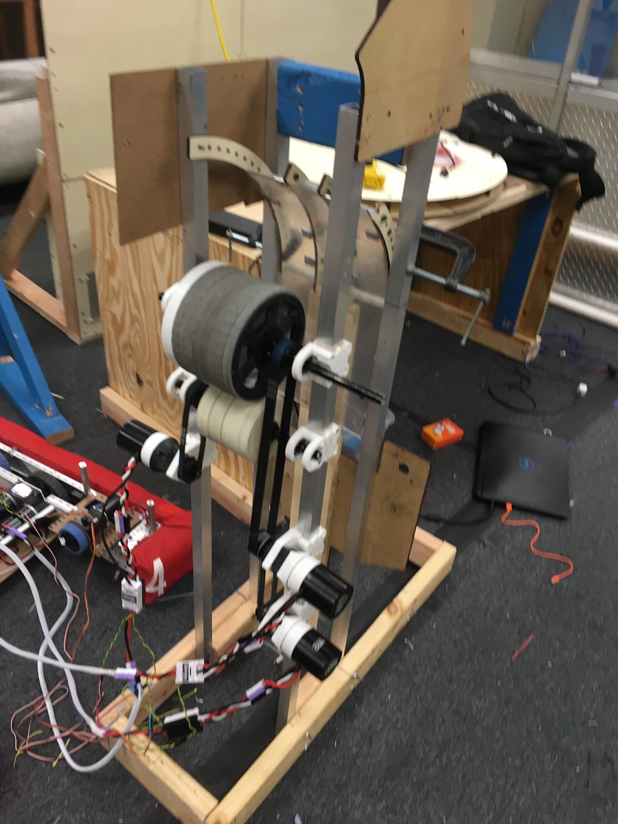

Since we want to try to shoot our 5 balls as fast as possible, we have a separate wheel that is powered by its own neo to help the balls get up to speed. Here is a photo of our prototype, the bottom wheel is 4 inch at a lower RPM providing better torque, and the Shooter wheel is a 6 inch wheel at 5000 rpm.

Could you provide details on your white adapter/bearing holder ? Assuming 3d printed parts?
Is this one of the spreadsheets that is posted here on Chief Delphi, or was it something that your team developed on your own?
They look like HypeBlocks
They are indeed HYPEBlocks, Max and 5254 did an awesome job designing them, they let us swap pulleys and belts really quickly. We have used those and our protopipe system extensively this season.
