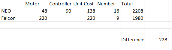

It’s about $220 more for NEOs instead of Falcons. Then you also have 7 Falcons you can use elsewhere.
It also seems like NEOs are going to come back into stock before falcons.

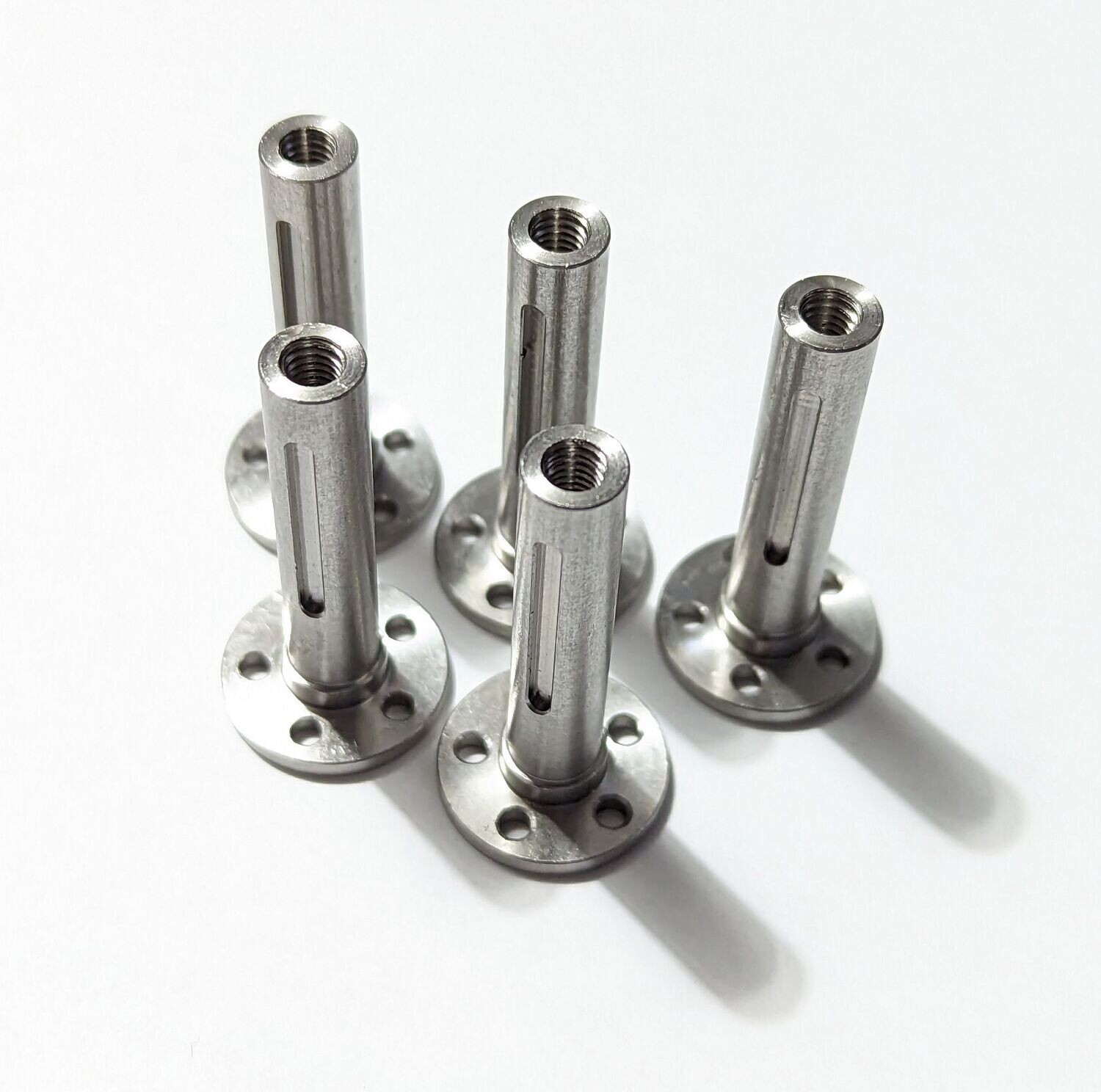

Also the (pinions I believe) for falcons and neos are different. I’m not sure what the best solution would be for a “hybrid” module

I believe the best solution would generally be Falcons for drive and NEOs for turning ( same motor for same function and weaker* motor for turning). At least as far as SDS, the two pinions that come in a module are identical so you just order half of your modules as NEO modules and half as Falcon modules.
