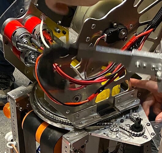

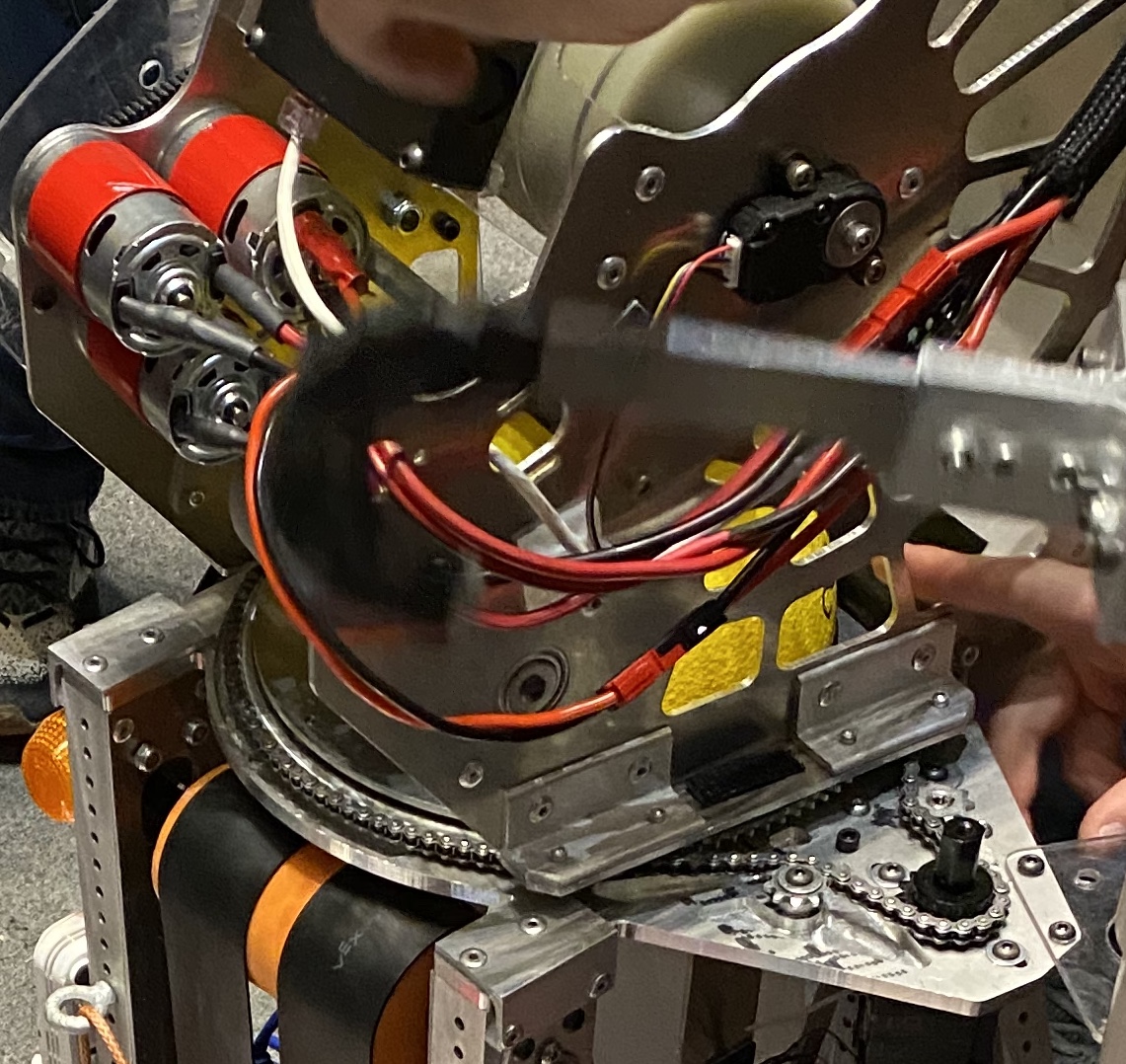

I don’t have a great photo of it, but we made our own turret – it was pretty simple.
Ohh, we were going to use a neo 550, completely forgot about the 775 option.
Definitely do the math on which motors you choose. We settled on a triple 775 pro config due to shooter wheel mass, wheel diameter and distance we wanted to shoot.
