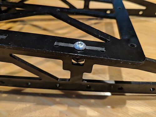

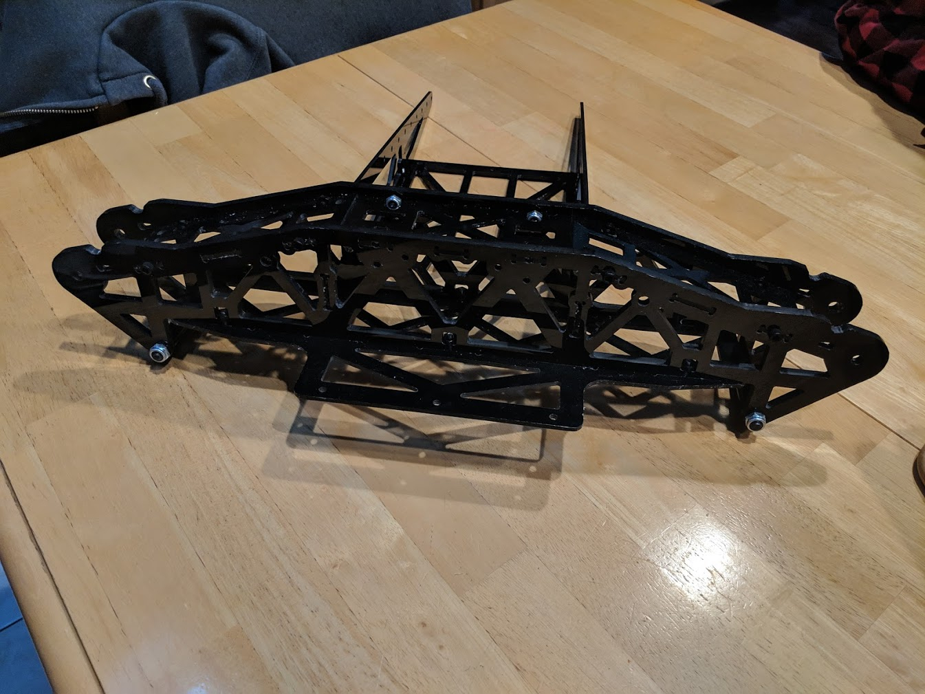

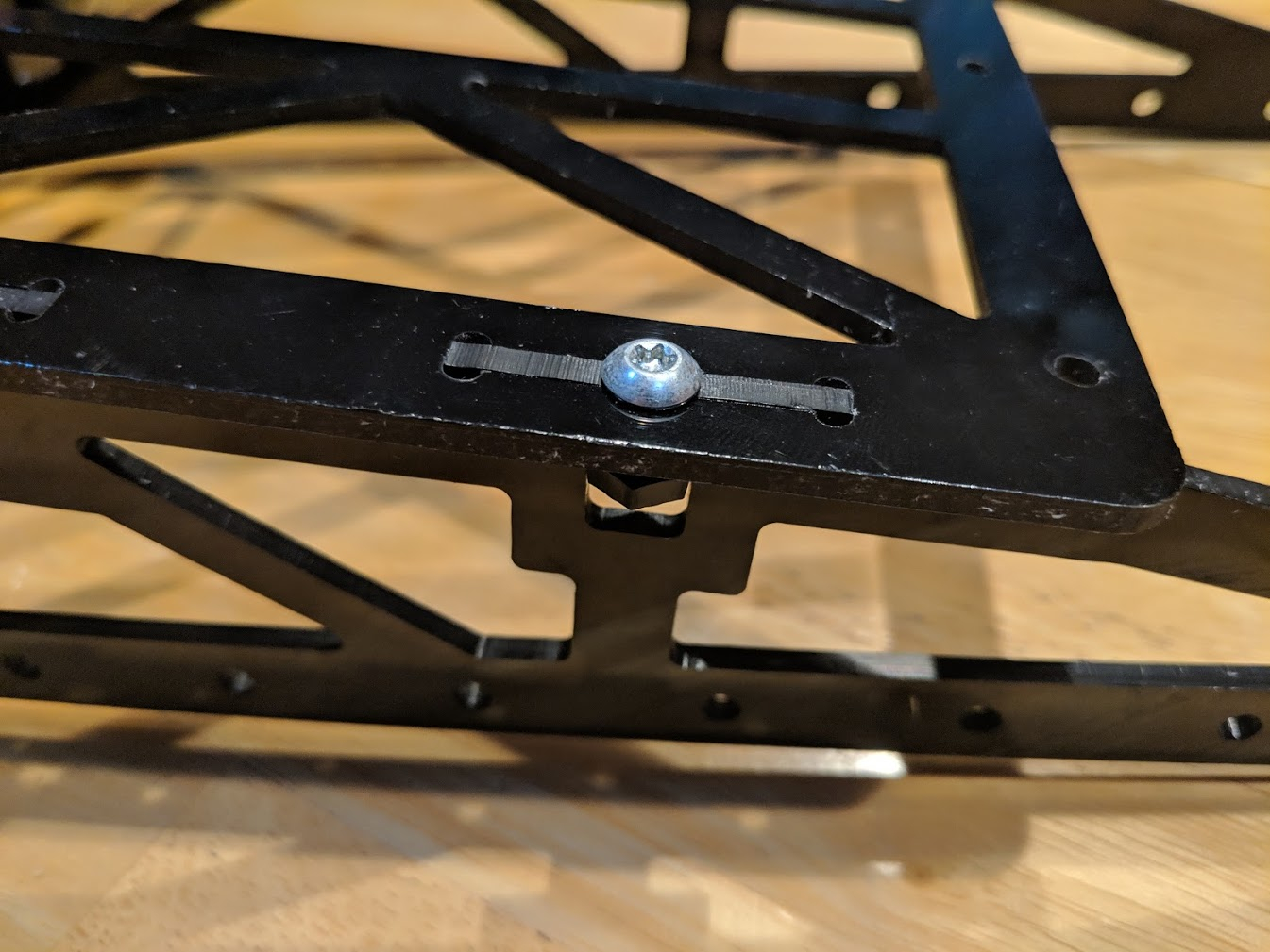

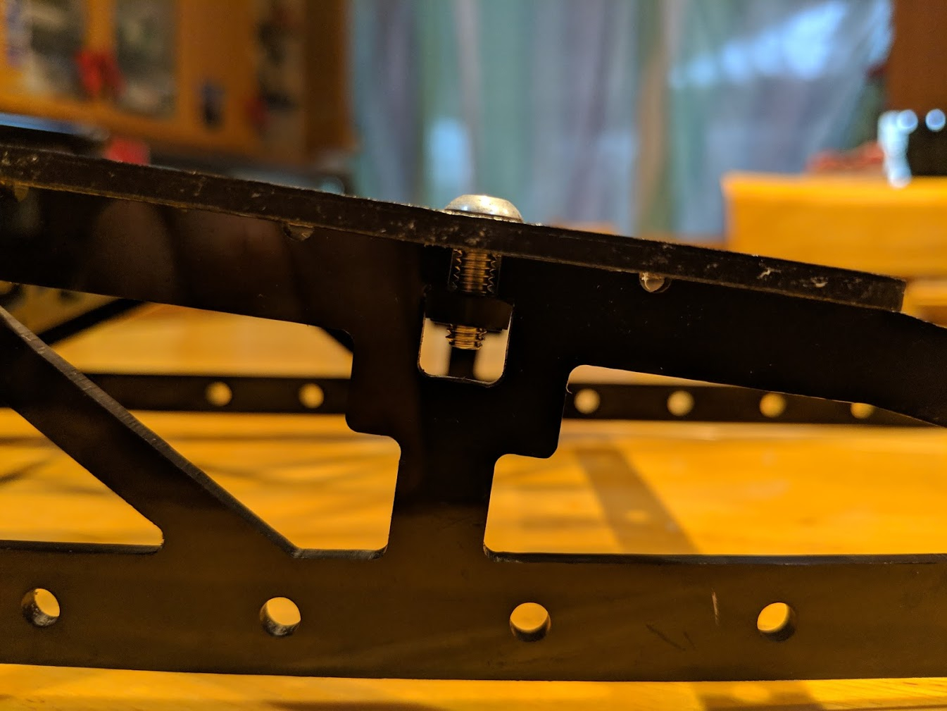

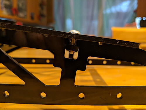

If you have a CNC router, you can build very rigid structures from 3mm (1/8") polycarbonate sheets by using the same type of interlocking tabs and fastening screws that the wooden Makerbots used:
No aluminum backing necessary, as the three dimensional structure provides for increased stiffness.

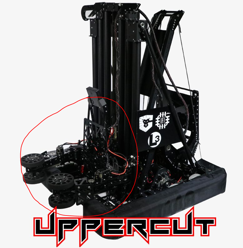

In my opinion, the best example of this type of structure I have seen is from your team. I was lucky enough to get one of the intake versions from 2018:
This is where this part was on the bot.
