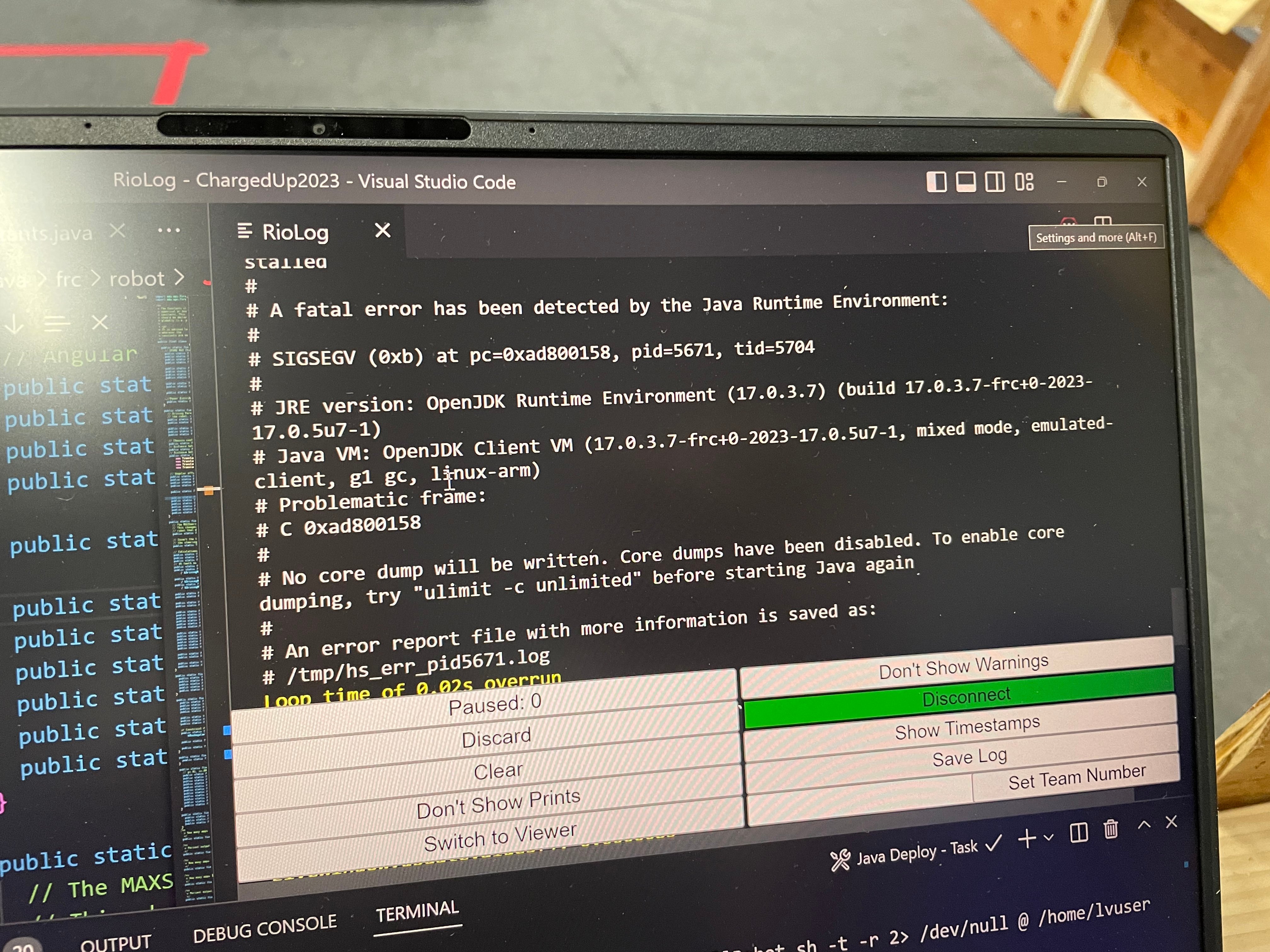

Same here for us today on 1591:
Is this issue specific to OpenJDK 17?
Also, make sure you update to the latest WPILib. We’ve fixed at least one memory corruption bug in the latest release (2023.4.1).
Thanks for all you and all the WPILib team. We this we had a few issues today where we had this similar memory crash, but we on 2023.3.2. Hopefully the update solves these.
Is this unresolved? I’m on latest Rio and WPILib versions, but just experience this crash. This is the first time I’ve experienced the crash before.
We also had a few crashes due to std::bad_alloc in the last week or so, including once during a match and twice during testing last night. During testing last night it was within a few minutes of freshly turning on the robot.
If you have a reproducible native crash, please see WPILib 2023.4.2 Release - #6 by Peter_Johnson for instructions on how to collect a core dump. I’ll also need to know what version of the libraries you’re using (at least the WPILib version in build.gradle and the vendor deps, preferably the whole project).
