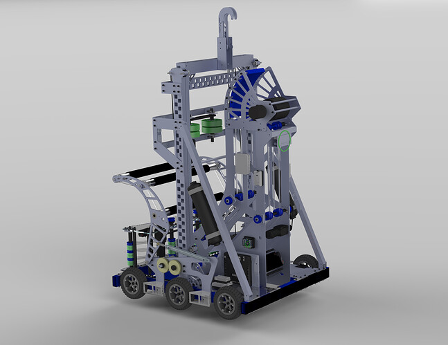

Gonna share 166’s 2020 robot CAD which features an elevator.
Team 166 2020 Robot | 3D CAD Model Library | GrabCAD

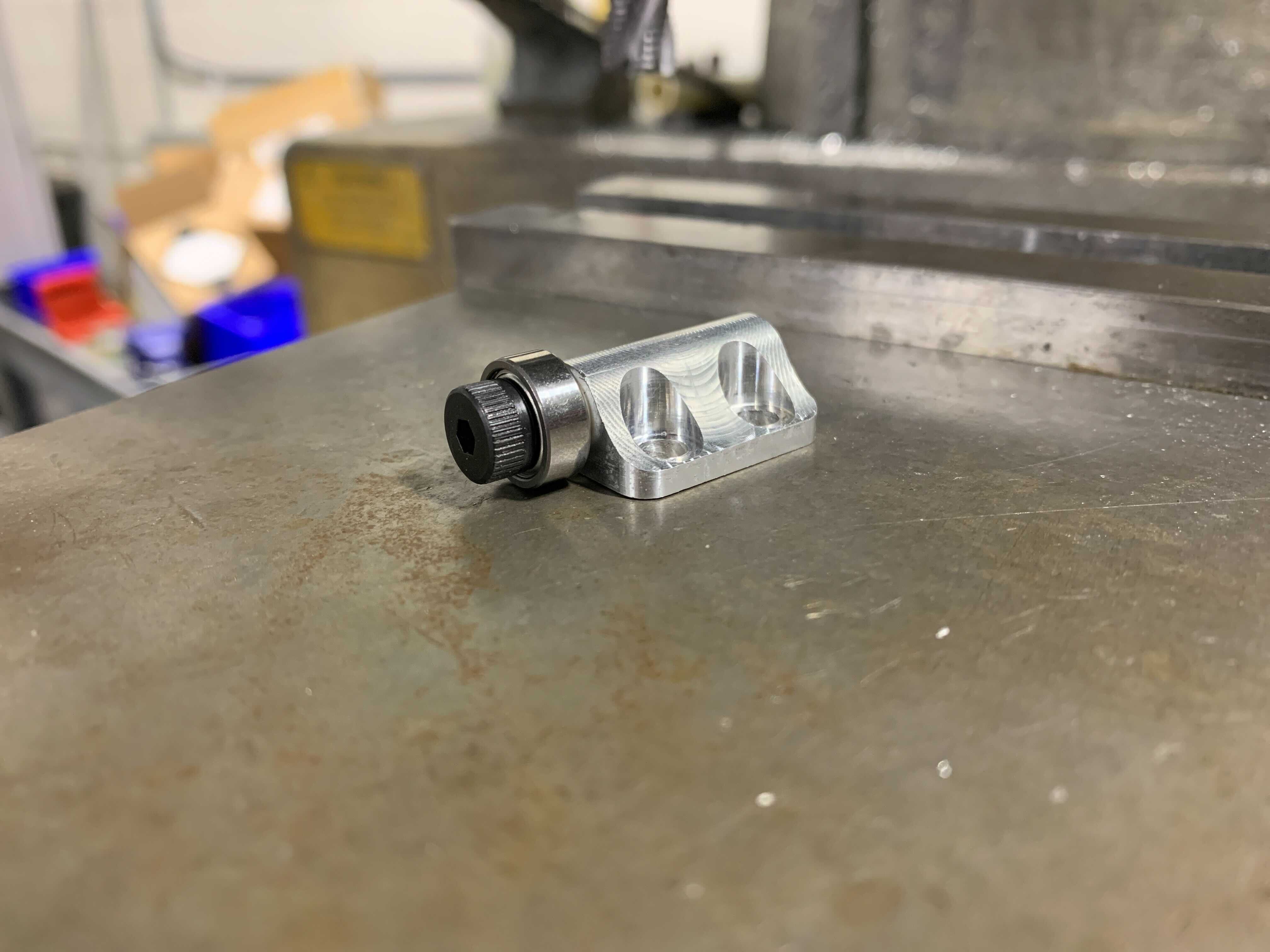

Personally I feel a good elevator starts with a nice bearing setup. Some of the 1086 seniors have been working on a “for fun” robot during 2021 (and we will reveal it on CD soon), here is a bearing block we are running on that robot.

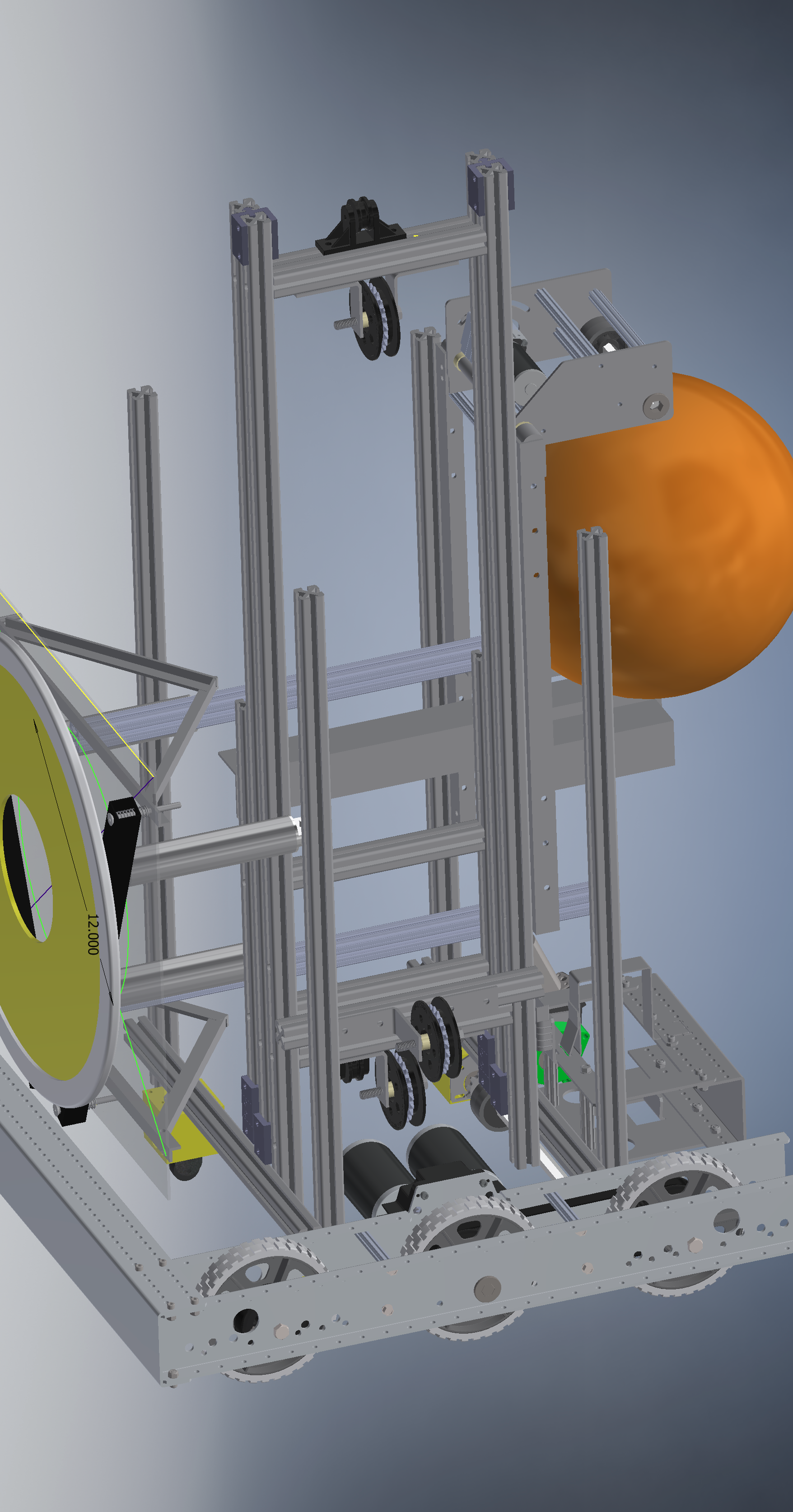

For a single stage elevator/climber we have really liked this design. It runs internal bearing blocks that we machined out of UHMW.
https://a360.co/3bUOBxf
I’m sure @RSimpson can give more information about it.

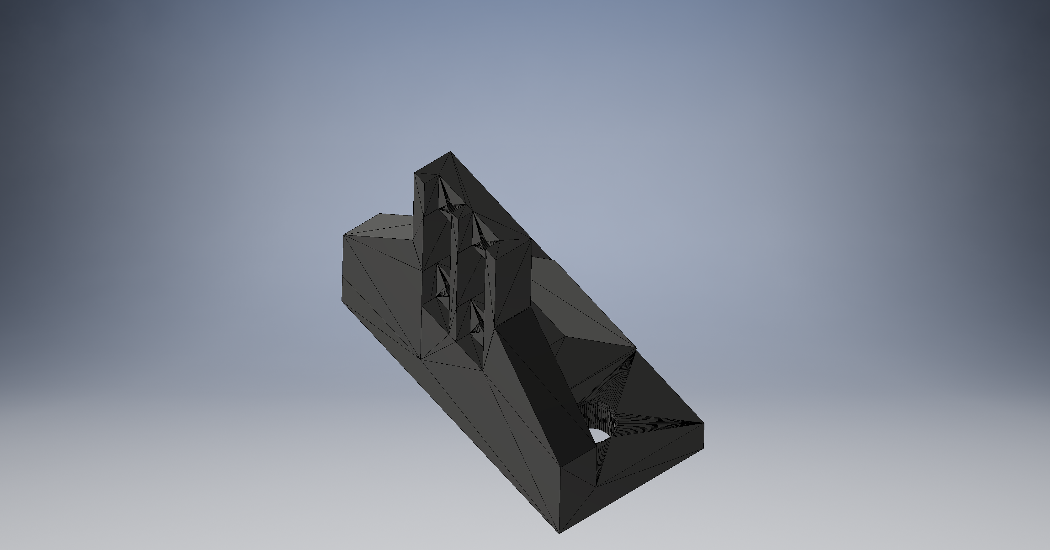

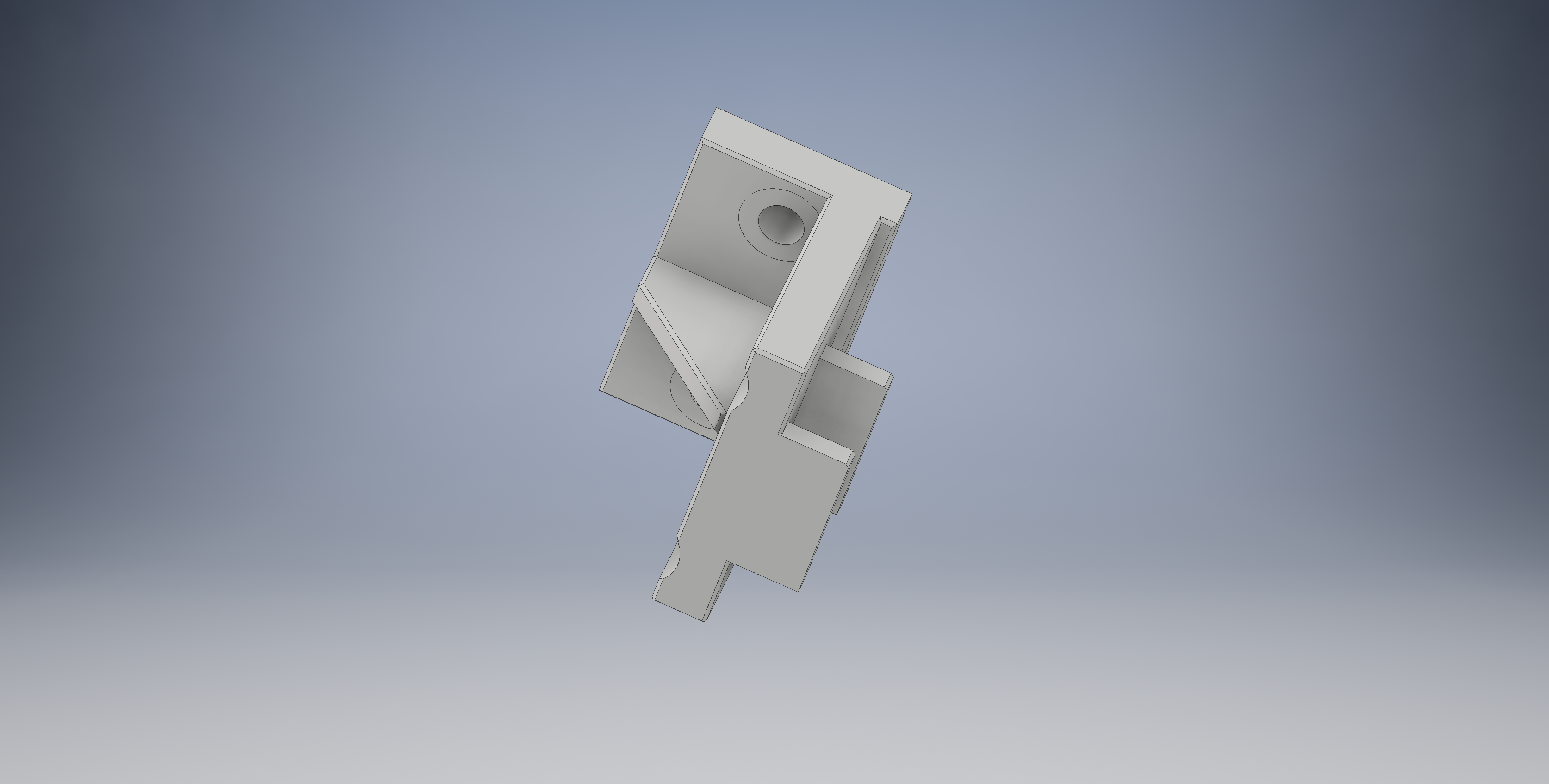

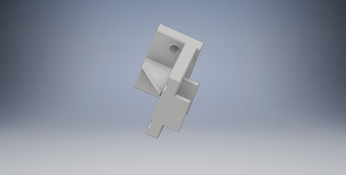

Team 3838 Roc City Robotix 2019 Elevator uses 8020 with 3D Printed ABS Sliders. 8020 is a little heavy but it is stiff. Using the custom sliders allows us to keep the inside and outside of the 8020 for mounting stuff.
In the picture top sliders on the last stage (carriage) are missing.
Sliders work as long as you do not have a twisting load. We mount one on the top of each side of the fixed first stage, and two along the bottom of sides for the second stage, giving us a larger distance to prohibit the sliders from locking up in the YZ Plane. We also have a slider that does not have the tab that sticks into the slot so you may use square tubing and save some weight on the last carriage. Sliders on the last stage would then be mounted to the carriage.
We wired the elevator using Cascade wiring with the first stage chain driven up and down using a CIM. The weight of the elevator causes the system to lower to the starting level and we use a small amount of current to hold the elevator in place after we raise it to position.
2nd and 3rd stages are wired in Cascade with an additional set of wires to drive the stages in the down direction too.
For position we used 3D printed flags and a dual optical slot sensor mount. Sensors are mounted back to back so that each flag trips the sensors generating a Quadrature [AB] output. We intended to use the AB signals to drive a Quadrature SW Encoder on the RoboRio. As we pass each flag it should increment or decrement by 4 counts. The flags mount in the 8020 slot so we may adjust the positions by moving them up and down. We call this a Linear Non-linear Quadrature Encoder. ie its a linear encoder with a nonlinear distance measurement.
Note that we ended up with one flag with sensors inline with each other even though we had printed two offset flags. We tried a 3D printed T-Nut that we could slip into the track but they didn’t hold up. The flag has to be longer than the distance between the slots of the two detectors so that we can generate the Quadrature output sequence.
(~A~B, A~B, AB, ~AB, ~A~B, …)
Unfortunately our SW was written to detect edges and generate a SW position instead of using the Quadrature Encoder method. Then during debug we had started with the elevator in a raised position, SW reset the count to zero, and enabled us to drive up until we crashed the sensor mount. This gave our SW team the impression that optical sensors and flags were not as robust as a hard wired limit switch. Limit switches were then added to the design.
Also note that each Slider has two 1/4" holes that we use with bolts to bolt through the 8020. If you use T-Nuts and smaller bolts to hold each side then you risk cracking the 3D printed part. We print the parts using ABS in the up/down (Z) direction so that the tab that rides in the slot has the greatest strength in the XY plane. We trim the part with a knife after printing as the bottom layer prints a little heavy.
For 2019 we mounted two different mechanisms, one on each side of the elevator with the elevator rotated relative to the robot. This made it easier for our Team to work on each mechanism separately. A little bit of spray Silicon Grease on each slider was used too.
We also used 3D printed parts for mounting the sprockets, and guiding the wires.

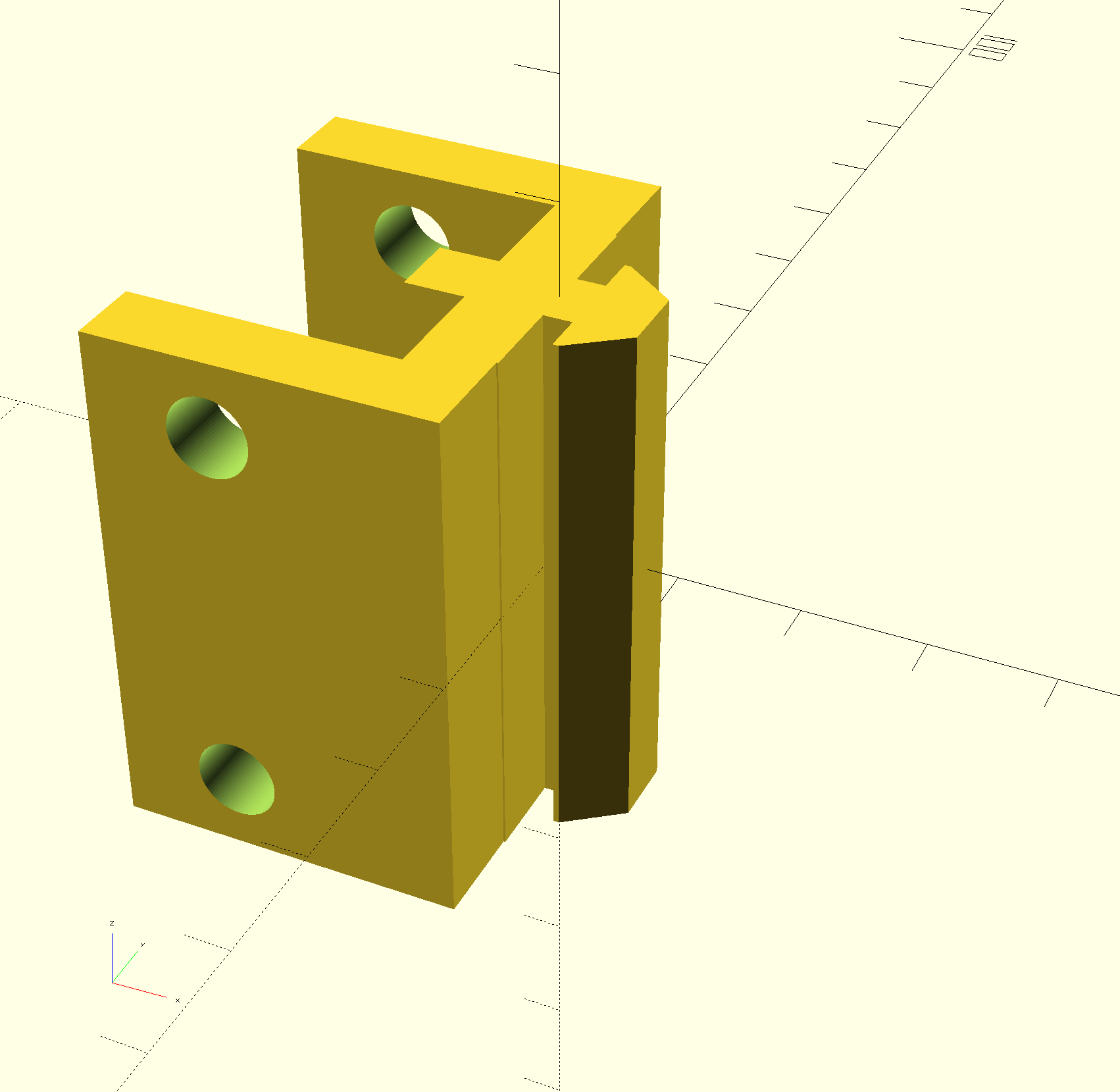

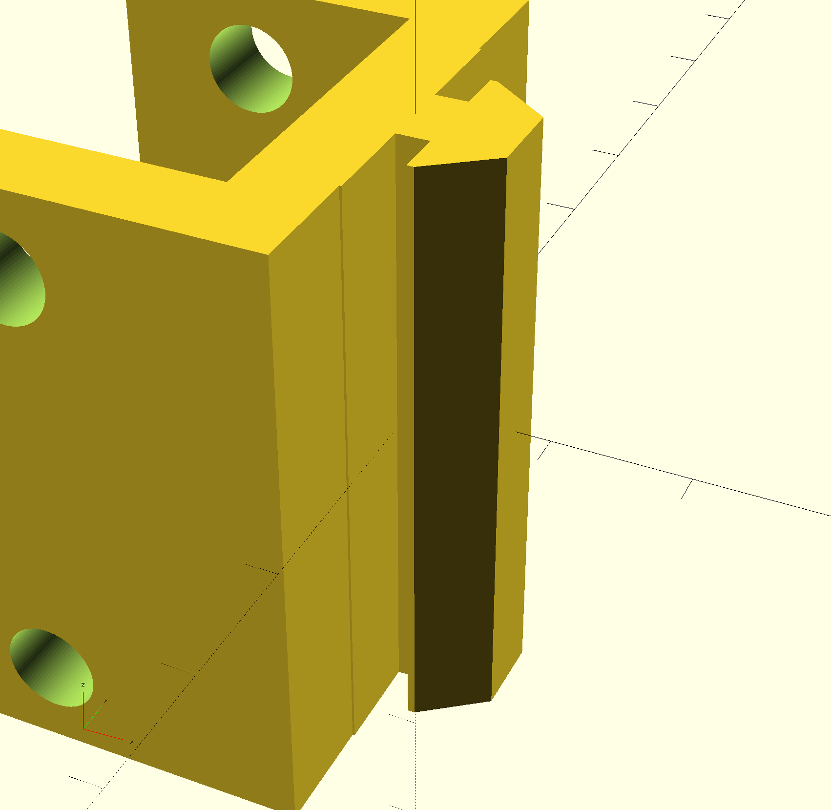

Open SCAD Slider Program.
// SliderV4-1.scad
// Written by Kurt M. Sanger
// Created 1/24/2019 All Rights Reserved
// 1/24/2019 New Version 3 using Polygon
// 1/24/2019 Version 4 added guide on inside of channel.
// All dimensions in mm.
// Define Guide that rides in Slot of 1010 8020 extruded aluminum.
WSLOT = 0.23025.4; // Width to fit into 1010 8020 slot for sliding rail.
W1 = 0.500
25.4; // Inside sliding rail widest width
W2 = 0.23025.4; // Width of the point inside sliding rail.
WBASE = 0.810
25.4; // Base of slide to reduce friction to fixed rail.
//DSLOT = 0.11025.4; // Distance between base and key that rides in slot.
DSLOT = 2.360; // Updated distance between base and key.
D1=0.020
25.4; // Distance before angle on tip of key.
D2=0.20025.4; // Depth of key that rides in slot.
DBASE = 0.15; // Raise the base to minimize friction
R2R = 0.250
25.4 - DBASE; // Rail to rail distance.
TS = 0.25025.4; // thickness of Sides of channel mount
WS = 0.900
25.4; // Width of Sides of channel mount
WC = 1.000*25.4; // Width of Channel to Fit Around 2020 Extrusion with clearance.
D3 = 5; // Depth of guide on inside of channel.
H = 1.7525.4; // Height of Slide
HD = 0.268
25.4; // Hole Diameter for mounting.
WIDTH=WC+TS+TS;
difference() {
//Union() {
linear_extrude( height=H, center=true, convexity=10)
polygon(points = [
// Guide
[0, WSLOT/2], [DSLOT,WSLOT/2],
[DSLOT,W1/2], [DSLOT+D1,W1/2],
[DSLOT+D2,W2/2],[DSLOT+D2,-W2/2],
[DSLOT+D1,-W1/2],[DSLOT,-W1/2],
[DSLOT,-WSLOT/2],[0,-WSLOT/2],
// Guide Base
[0,-WBASE/2],[-DBASE,-WBASE/2],
// Channel Mount
[-DBASE,-WC/2-TS],[-DBASE-R2R-WS,-WC/2-TS],
[-DBASE-R2R-WS,-WC/2],[-DBASE-R2R,-WC/2],
// Add inner guide
[-DBASE-R2R,-WSLOT/2],
[-DBASE-R2R-D3,-WSLOT/2], // Comment out this line to eliminate tab.
[-DBASE-R2R-D3,+WSLOT/2], // Comment out this line to eliminate tab.
[-DBASE-R2R,+WSLOT/2],
[-DBASE-R2R,WC/2],[-DBASE-R2R-WS,+WC/2],
[-DBASE-R2R-WS,+WC/2+TS],[-DBASE,+WC/2+TS],
// Guide Base
[-DBASE,WBASE/2],[0,WBASE/2],
// Back to Guide Start
[0,WSLOT/2]
        ], convexity = 10);
    translate([-R2R-12.7-DBASE,0, H/2-6.35]) rotate([90,0,0]) cylinder(d=HD,h=2*WIDTH,center=true,$fn=100);
    translate([-R2R-12.7-DBASE,0, -H/2+6.35]) rotate([90,0,0]) cylinder(d=HD,h=2*WIDTH,center=true,$fn=100);
