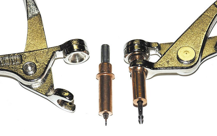

Not so much a new discovery, I used to use this 6 years ago on my old team and only just remembered about them. 1640 recently started using rivets this year so I plan on introducing them to these for 2020
They’re so useful for holding riveted parts together before you’re ready for the final rivets. They can even be used for prototyping if you don’t want to put nuts and bolts everywhere.
We use rivets for 90% of our elevator and have had to drill out quite a number. How do these work? (Feel free to PM me if you don’t want to continue discussion in this thread)

A cleco is like a temporary rivet - you use the plier-shaped tool to install them. The reason to use them is it lets you temporarily hold the entire frame of whatever you’re riveting together, so you can easily square up this frame and make sure everything lines up before you commit to rivets. You can reuse clecos as many times as you want. The way that they work is easiest to explain with a picture:
When you use the tool, it pushes the hooks inside the cleco down. Doing that allows the barb shape to grab onto the far side of whatever you’re fastening. When you let go, the barbs expand and hold it tight. To remove them, simply use the plier-shaped tool again and yank it out. They don’t damage or mar the parts in any way.

+1 for clecos. We slightly undersize our rivet holes and then ream them out to get a perfect rivet fit.
