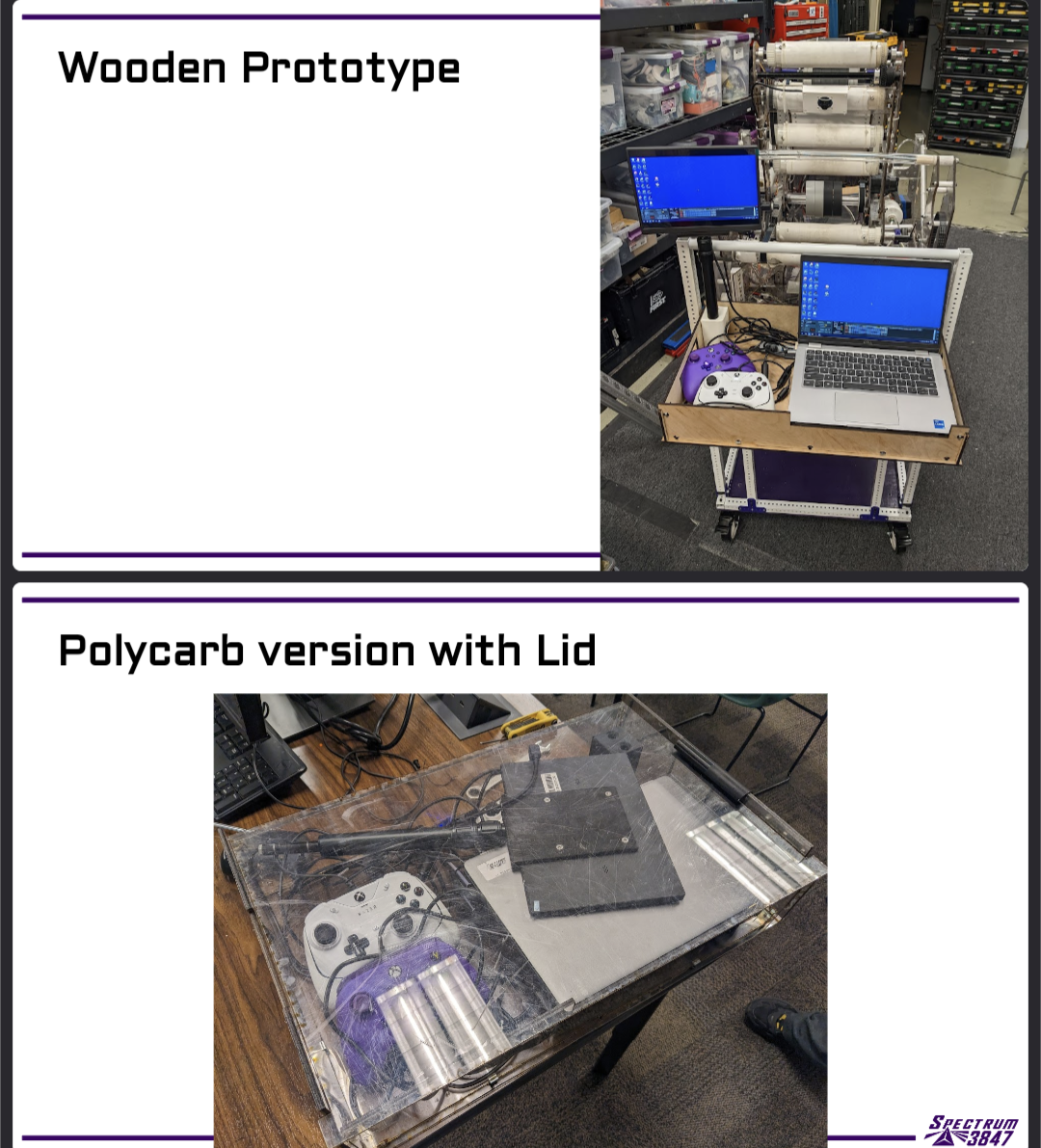

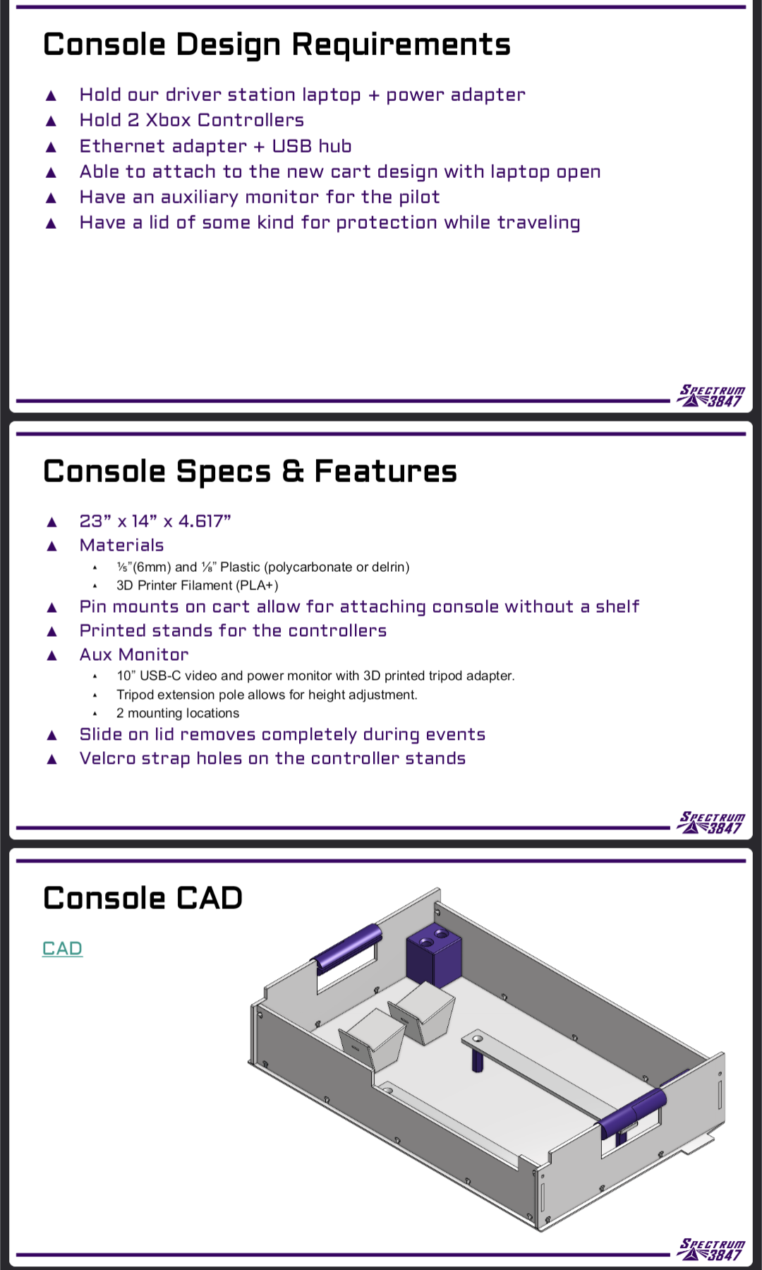

Spectrum is in the process of updating our operator console and we’ll publish the specs and CAD around the start of the build season. Here is a preview of what we have so far.
