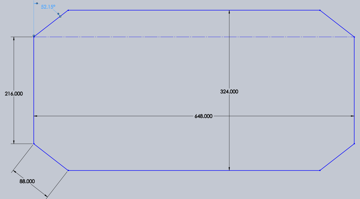

For those still wondering, the angle of the feeding slot wall in relation to the alliance wall is 52.14709727 degrees
The attached image shows the basic way to figure this out in CAD software.
The four corner walls were contrained equal to each other, the two alliance walls constrained equal to each other, and finally the two side walls constrained to be equal to each other.
