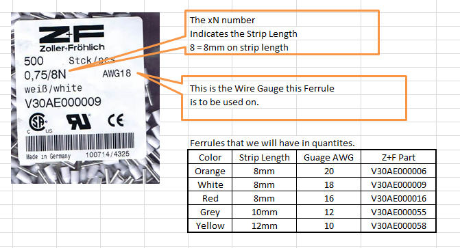

I know it was mentioned last year that the Weidmuller connectors on this control system were also designed to work with ferrules. Did anyone do this last build season? Did you find it easier than just inserting stranded wire? What size ferrules did you use? Where did you source them from?

For the size part of the question I used a range of sizes for the range for the sizes of wire on the robot. With the different colors it kind of gives it a color code for the different sizes of wire.
McMaster has the full range of sizes with choice of colors. You can probably find them cheaper else where.

We had mixed results using wire ferrules last year, and the inconsistency came from one of the two crimpers we used.
One of our crimpers left a smooth surface on the crimped ferrule, and they tended to pull out of the spring-loaded Wago/Weidmuller type connectors pretty easily. The other crimper put a series of ridges across the crimped ferrule, and these were retained much better by the spring-loaded connectors.

We also had mixed results. The ferule connectors worked GREAT in the PCM and the VRM but did not work well at all in the PDP. Even with the crimping process creating ridges that the Weidmuller connector could grab we found connections pulling from the PDP often. We ended up leaving the ferule connector on items connected to the PCM and VRM and tinning the ends of stra
nded wires going to the PDP in order to keep them in place.

I tried using some “wire pin” crimp lugs last season, like the ones linked below. They did not work well because the pin part was a bit big to fit into the small Weidmuller connectors for the low current 12 V connections and the CAN connections. The crimped part also ended up too big to be able to fit more than 3 of them with the 3 mm center-to-center spacing of the Weidmuller connectors.

Not all ferrules are created for this application. My recommendation is that you stay with Weidmuller devices designed for this termination and use only the approved crimping tool. The terminal is designed for a specific cross section that the crimp tool provides.
