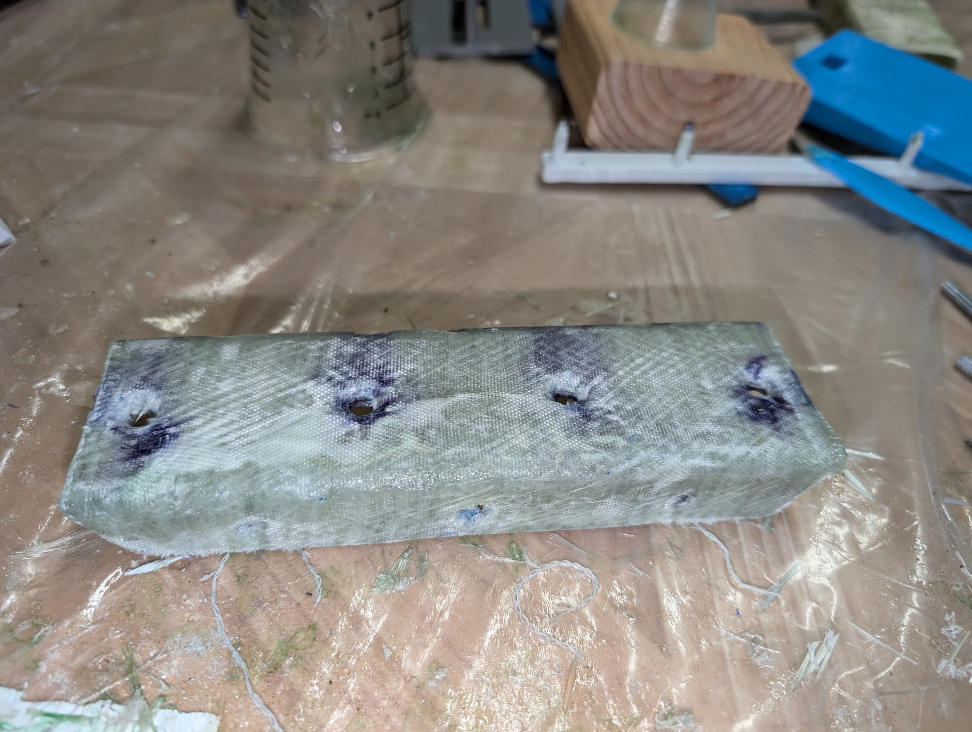

Investigating As to make a FG frame with had tools. I need a frame for my drive train tests and as I always wanted to do some FG stuff - well I am doing an FG frame.
What I decided on is an octagon as it gives me more room for pickup and other mounts it will have the corners of a rectangle cut off with a diagonal turning it into an octagon The FG will be Uchannel with holes every 2 in or thereabouts (not always 2 inches at corner. I decided on compression mold after some tests as its stronger and lighter (less resin). I made tests atm with both expoxy and Polyethylene and for now use polyethylene mostly. The epoxy is stiffer the Polyethylene takes more of a beating (boat resin hence that is why they use it in boats) . The polypropylene smells more but that is what I got PPE for and good ventilation in my new shed.
So here is my 2nd try (first one did not work out so fine)

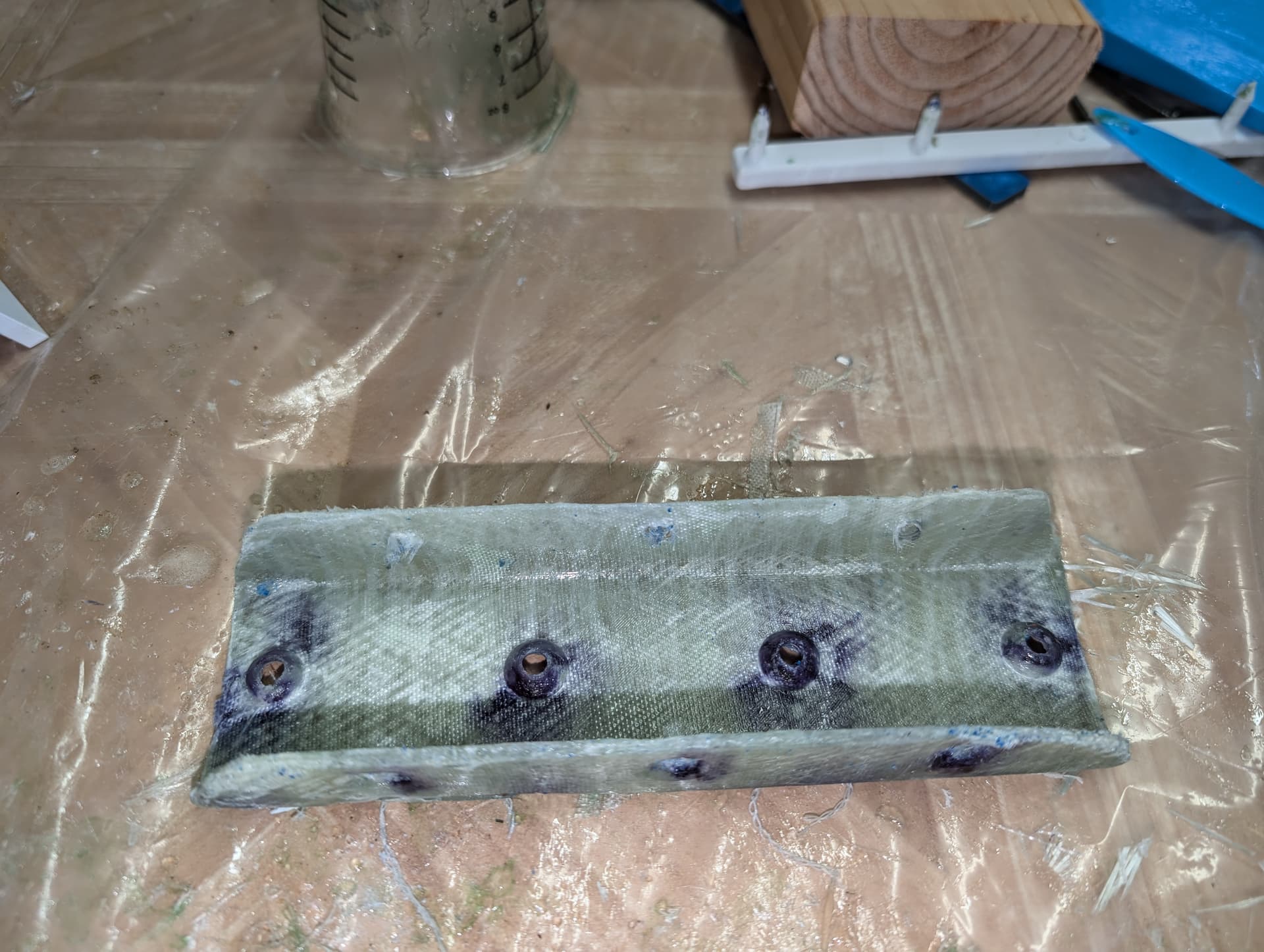

The discoloration is from me making my marks on where to cut etc on the Glass - I got to do that differently probably make a template

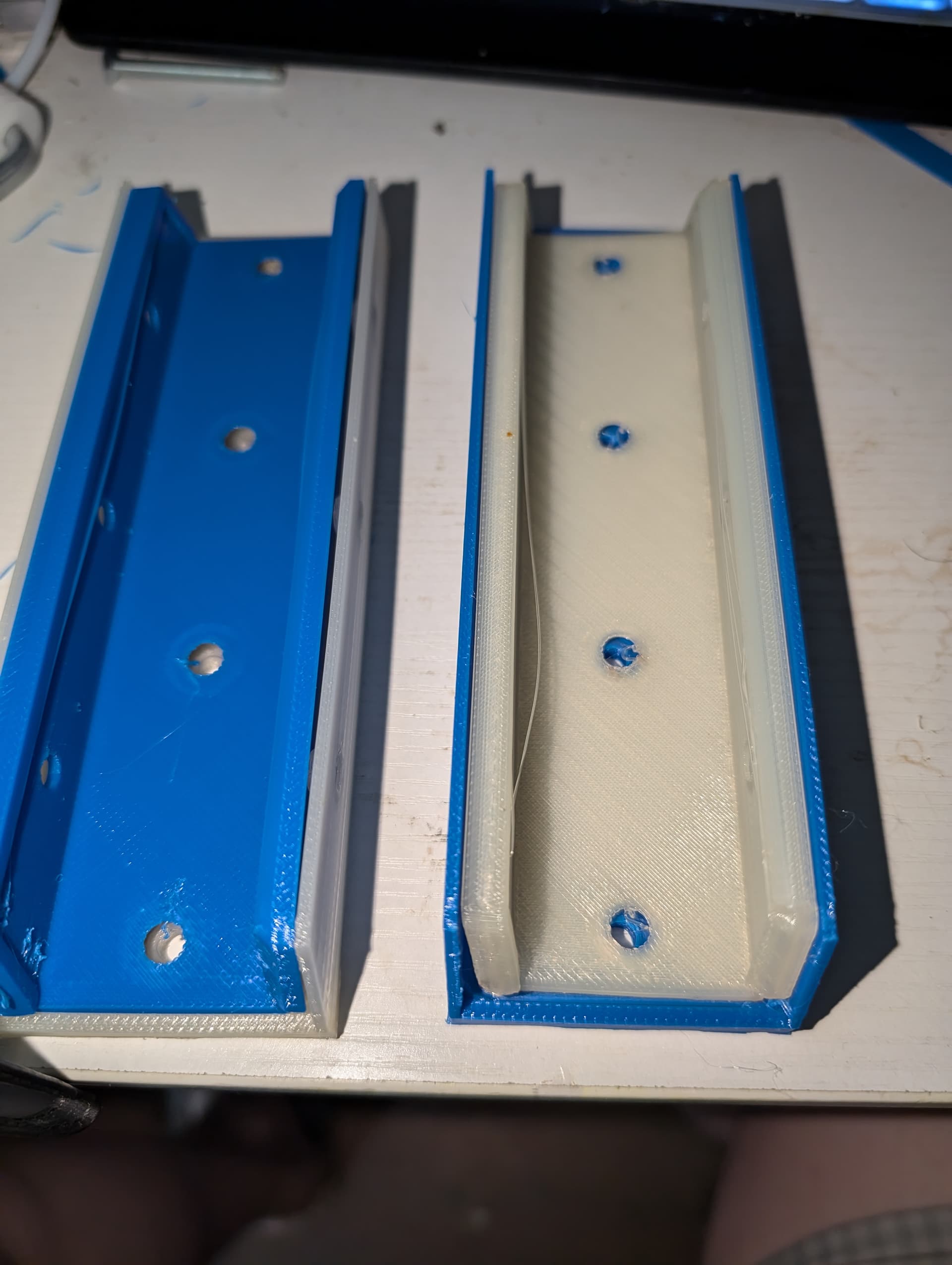

Wall thickness is 2 mm and consists out of 3 layers of 1700 coaxial mat and on then on each side 8 once cloth. Then the bolts through the mold squeezes it down to 2mm.
This is basically the idea - I make them thicker now as those even with backing did not stay straight enough. For Mold material I have not landed on a choice yet and trying ABS, PETG and Nylon . Nylon is probably best with Epoxy but not that good with Polypropylene as even with release agent (wax and PVA) it sometimes sticks too much as you get it through the holes. (still something to work out).
The 7 in piece in the pic suspended between the ends will carry my weight (300 lb) and can be hit full force with a hammer. (not very scientific test I know) . The weight projection for a whole frame is going to be somewhere between 6-9 lb depending on configuration (excluding wheels motors, gear boxes etc of course.

In resin so far I have tried both polyethylene (boat) resin and epoxy. For a school setting probably epoxy is better as it smells less. For me boat resin is probably the better choice its less expensive and way more impact resistent - hence that is why they use it for boats which take a pounding in the waves and robots take a pounding too. Mold making is a work in progress. And I just destroyed one cause the bolts going through it also made the holes in the part for bolt holes and the resin escaped through the threads and made demolding impossible without destroying part of the mold (so back to the drawing board/Computer cad)
