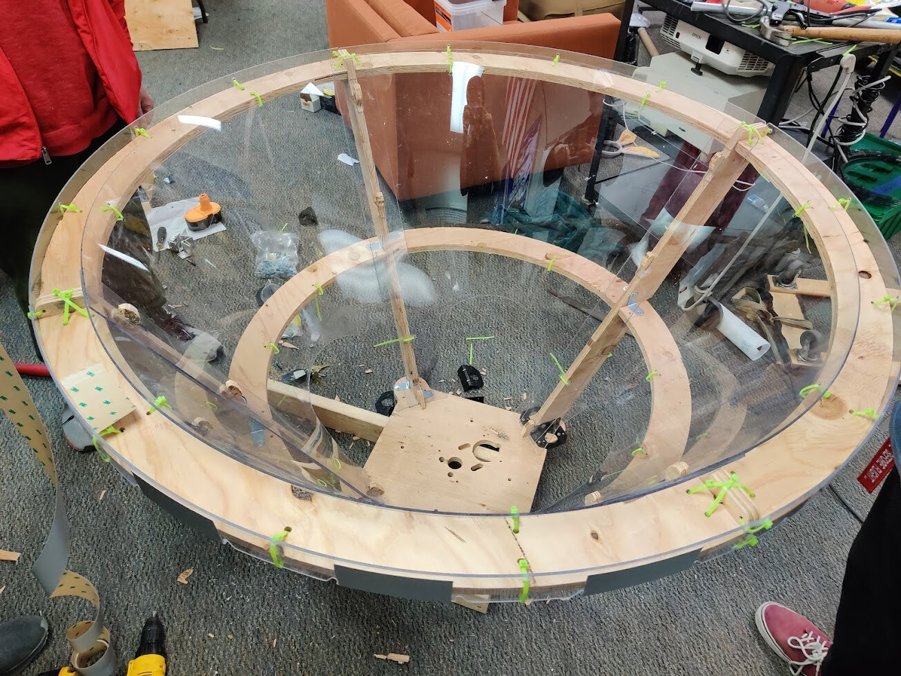

You can download the Andymark replica CAD model and cut out the 1/2" plates with 1/2" plywood (or modify the design to utilize 3/4" plywood which is what we did). To cut out the polycarbonate pieces, you can flatten the curved model and cut it.
Here’s a photo of our setup:
