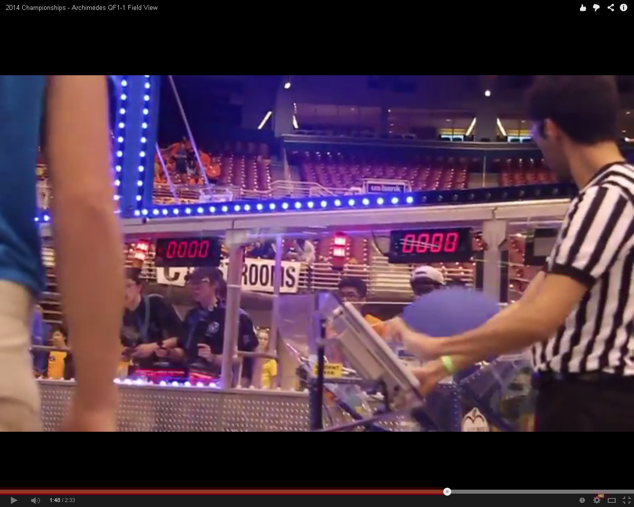

I was just watching a video from QF1-1 on the Archimedes field. The most interesting thing that I noticed other than the amazing match was a split second where the team numbers on the field turned from the real numbers to 0000. This really made me wonder what is happening with the FMS.
This is just an interesting picture, I thought I would share.
Video:https://www.youtube.com/watch?v=V2EFDNlXnJQ
1:47-1:48 Field Glitch
I noticed the same thing. Could this be related to the teleop/auto switching but 254 saw at SVR? Or is something else in FMS just going of into the weeds?
I doubt that it has anything to do with the Auto-Teleop issue. The Team LED Lights are connected to the PLC in the Station Control Cabinet behind Driver Station 2. The robot communication traffic is routed through a managed switch that is also housed in the SCC, but does not interact with the PLC. As far as field Electronics mis-behaving, the Team LED’s are probably the least concern possible.

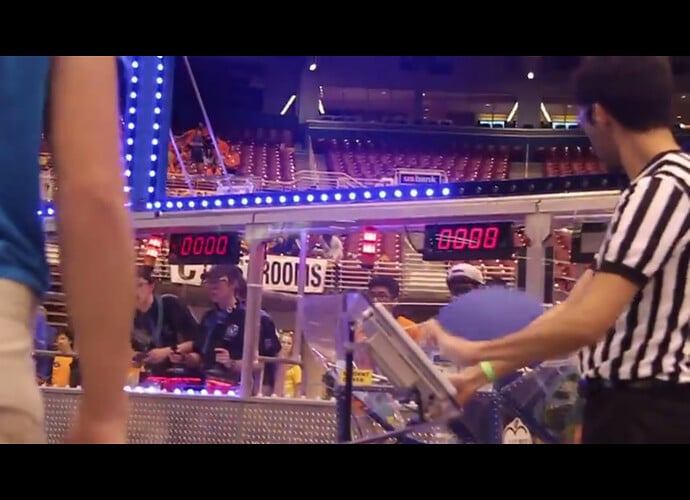

Also, I was going through stills of the video and found one just after 1:48 that shows the field timer still working but the two Team LED displays are 0000. Since the LED displays are wired in series, I am wondering if a problem there may be the issue.

I saw this on Galileo once as well, and we had a similar “issue” while setting up the field at 10,000 Lakes.
At 10k Lakes the cause was a bad cable running between two of the signs.
This typically isn’t a symptom of an issue with the FMS. It could be a bad cable, or it could have gotten jostled in just the wrong way from a robot or a ball hitting the alliance station.
This is generally caused by a bad cable or bad connector on the team LED displays. This likely isn’t an FMS software problem.

Correct. We had this at MSC and it was loose connectors. Not the FMS.

I saw this at Groton, Hartford, a few videos on TBA, and Curie. It happens when robot drive into the driver stations at high speeds. At Groton, a guy kept unplugging the ethernet cable to the driver station control box, and eventually replaced it.
We noticed this back in Utah after watching our GoPro videos. We asked a field tech and they said there was a known issue with the FMS running on the CRio in LabView that powers the stations. They told us it didn’t effect the match only the displays, and that there was no solution to the problem. I know the Acchemidies field did it because it was the same field used in Utah.
The running from 0000-9999 is part of the self-test from the displays at power-on. Someone might have stepped on the power cable or something or just a flaky connection at the power strip. I had one display on the Phoenix field that was being a pain that I worked with when the same field was being set up in Las Vegas and turned out to be the connector was loose…tightened it up and it behaved for the event.
The displays have no actual bearing on the FMS other than showing to the participants/spectators who is in what station and the match timer, which it receives and sends nothing back. You can unplug them completely and the FMS wouldn’t care…think like the clock not showing correctly at a football game and the time then being tracked using the Umpire’s clock, which is the real official one at a football game anyway with the scoreboard one being for the crowd to see.
