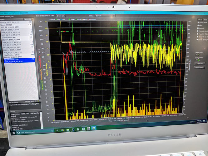

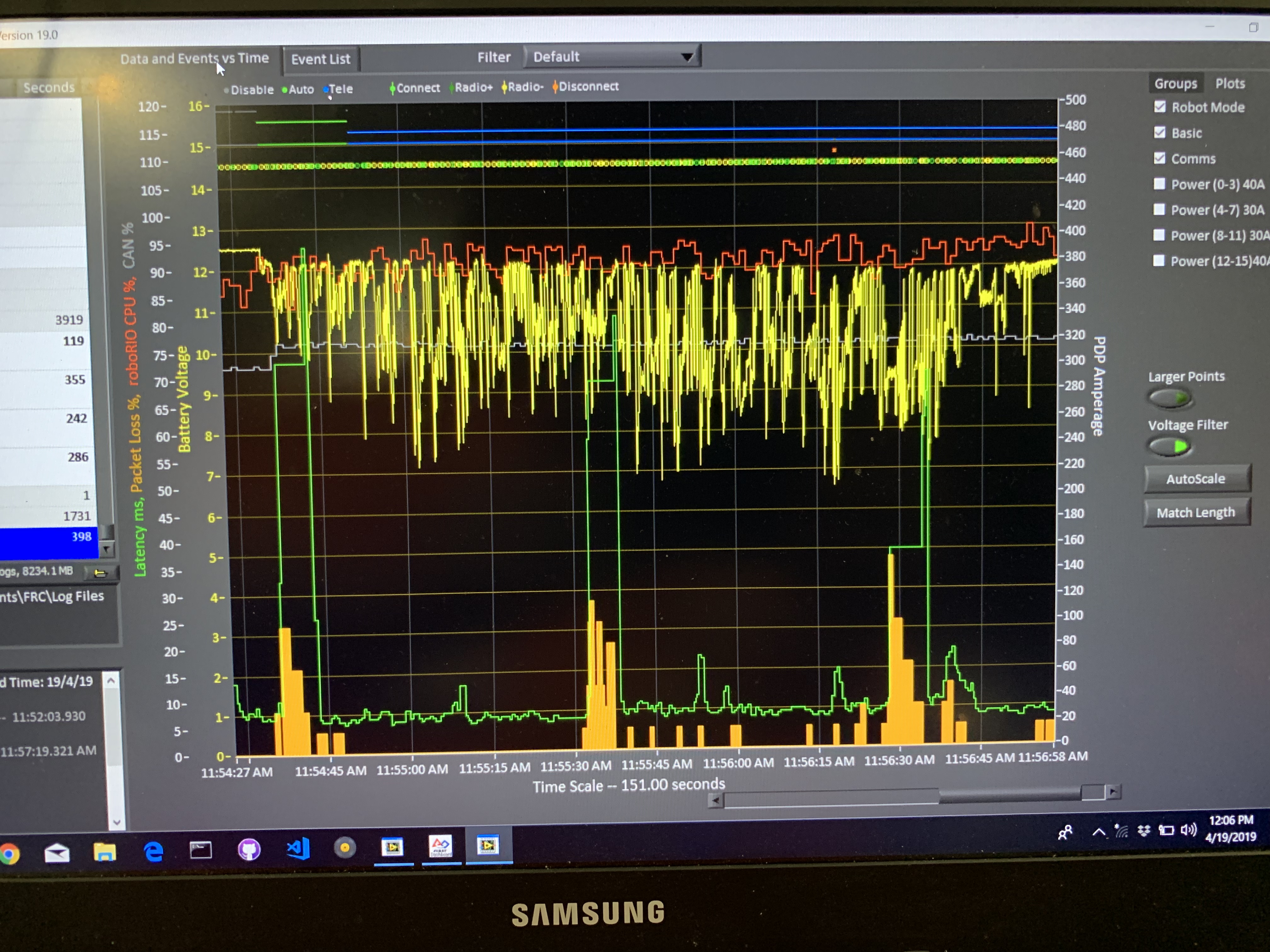

Even though carver officially only had 1 replay, the field issues were continuous throughout. Looking at our driver station logs from any of our matches the packet loss was insane.
Our drivers also complained several times about lag interfering with the robot operation, including (but not limited to) robot continuing to turn for half a second even after letting go of the stick, our limelight network tables not communicating for a brief second and causing our drive train pid to go haywire, and the driver camera stuttering frequently.
I’m also aware of several other teams on carver that had similar issues. We showed the FTAs the logs several times, just to make them aware of it (and they did acknowledge the insane packet loss), but we personally never pursued a match replay since none of our match outcomes were affected by it.

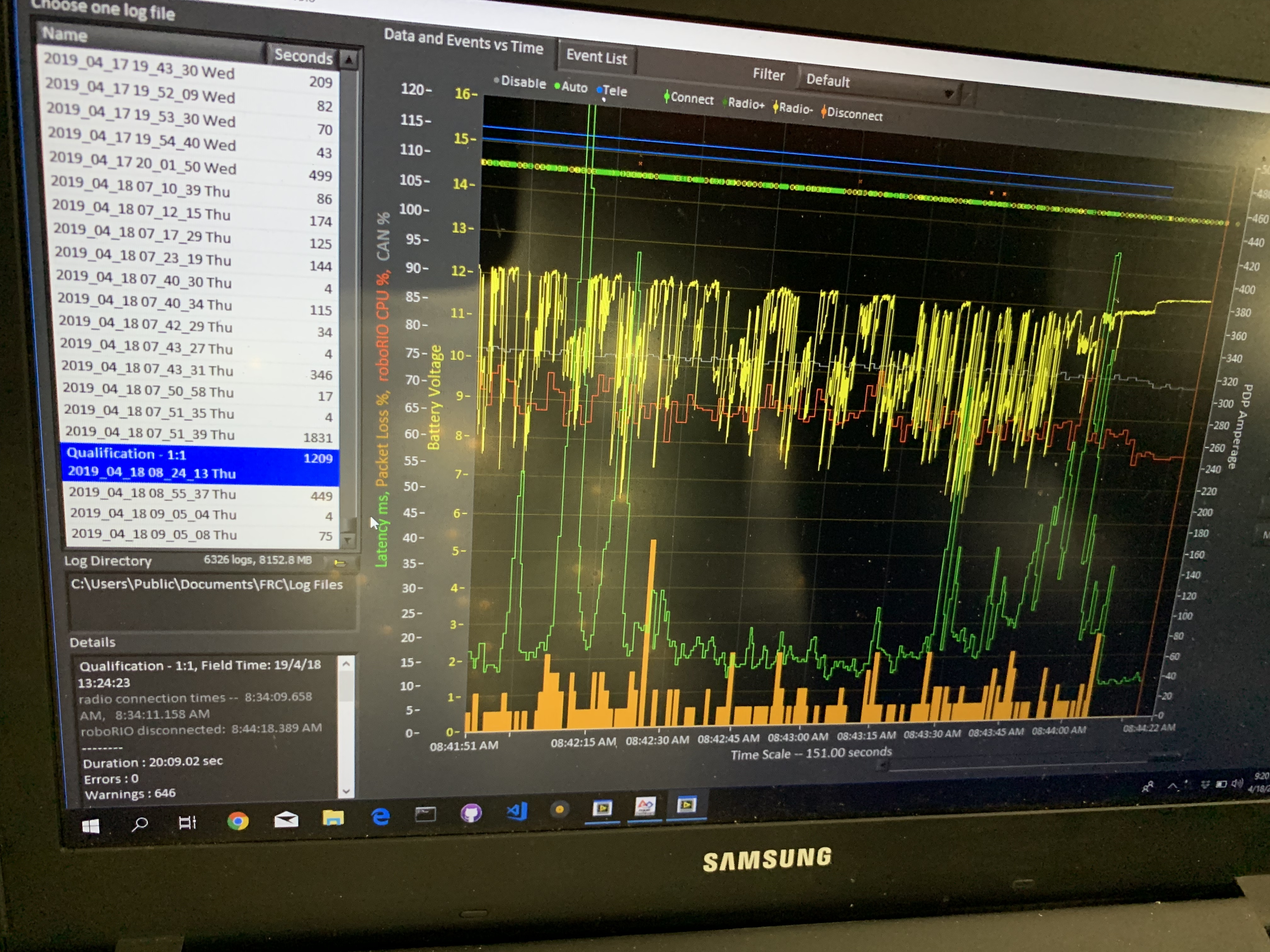

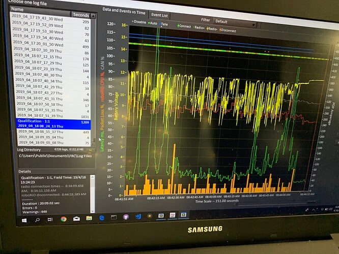

On the other hand, Newton, which was right next to Carver, probably had the most replays. I think we had some teams playing 3 replays. Seeing the latency graphs teams were bringing (including ours) to the FTA was mind-boggling.
