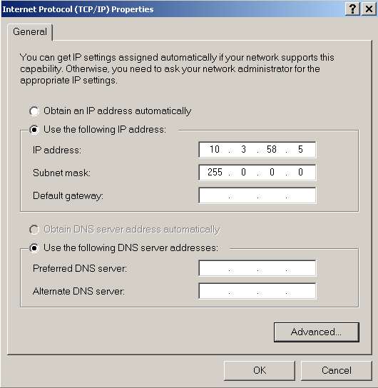

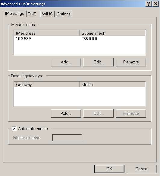

To expand on the situation behind this - the WPA configuration kiosk apparently has sporadic problems and will report a “failure to configure IP, wrong operating system” error (or something like that - can’t remember the exact wording, sorry!). Usually the bridge will still be configured OK, but better safe than sorry. Hopefully the word can get out to the other regional volunteers so everyone knows the correct kiosk procedure is to plug in ethernet 1st, then power 2nd.
To expand on this, using DS Rev 01.05.11.00 but having multiple IP addresses configured on the network adapter will also mean your robot will never link to the field. I think this is what jhersh meant when he euphemistically explained that DS rev 02.27.11.00 would “ease proper configuration of the driver station laptop’s IP configuration (making you more likely to successfully connect to the field).” Prior to rev 02.27.11.00, setting the team number in the DS config just set the additional IP for your team without getting rid of any additional pre-existing IP addresses that may have been configured.
Several teams at the Trenton regional found this out the hard way when they borrowed Classmates from spare parts - the spare parts classmates all had DS rev 01.05.11.00, and also had an existing IP of 10.0.0.5. - so any team using a spare parts Classmate could not connect to the field initially.
Again, better safe than sorry - probably best not to consider DS rev 02.27.11.00 “optional”.
Huge thanks to all the Trenton volunteers but especially Mark, “NI Greg”, “NI Ben”, and “FTA Pete” for all the hard work!
  • Ron
    Team #2607 controls mentor
It can be an issue for teams who switch their IPs around a lot, or if you borrow a laptop from another team or Spare Parts.
That’s why the vast majority of teams won’t see this.
It’ll only cause a problem the first time you go to use it.
If you connected at least once before by tether in the pits then you’re good and it won’t crop up later or anything.
The way to tell if this was happening to you is pretty simple.
The symptoms are: the Driver Station can’t see the robot on tether.
If you check your IP settings use the Advanced button down at the bottom (1st attached image), and you’ll get a list of the IPs associated with that network adaptor. Just delete the extras that shouldn’t be there leaving you with one IP address as in the 2nd attached image.

Quick question on the DS tethering - the students say they were able to tether successfully with the borrowed Classmate and “multiple IP” situation before going on the field…they would have done that to charge the pneumatics since we have an off-board compressor this year. So I’m wondering if the multiple IP problem is a cRIO issue, or an FMS issue?
Anyway, safest procedure is just to check the IP settings!
