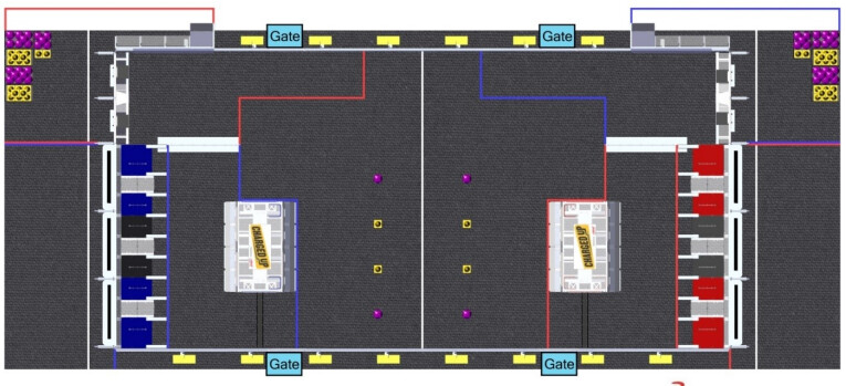

Am I missing something or is that field layout out VERY wrong. look at how the loading zones differ from the manual
screen shot from that match
screen shot from the manual with correct loading zonae markings
Part of me wishes this is FIRST testing out a change to the layout which will come in a team update but realistically the volunteers setting up got it wrong and people didn’t notice. It’s crazy that it got that far given that FTAs are supposed to measure various parts of the field for compliance with the manual.

I legit can’t see what is wrong
The line for the panhandle of the loading station is off by almost 6ft.
The “chicken legs” of the loading zones are too short, and end at the field gates.
I don’t know if we’re watching the same match (I’m guessing you meant Finals 2?). The vast majority of the defensive interactions wouldn’t have been illegal with correct loading zones, and red would have potentially actually drawn more G207s with the correct zones (obviously they probably don’t take the same routes if the zones are taped correctly).
From the stands it also appeared the spots for the starting game pieces were not parallel with the midline/community lines. I never measured to verify though, we had enough other problems to deal with.
Oh i see now that’s a big thing to miss when you’re building the field
Hi, FTA from FIM here (not the one at said event). We are aware of this and working on improving internal documentation and procedures to ensure this won’t happen again. We apologize for any impact this may have had on teams.

A fun thought exercise: Imagine the field in the manual was as implemented at Escanaba, and you wanted to build a “Wall-Bot” to shut down access to an alliance’s game pieces with a single robot. I bet you could do it within the rules.
based on my rough estimate of where the line was, if you made a roughly 16in wide 52in long robot with a 4 ft extension you could make a wall that touches both the field wall and the barrier. That would make it impossible to score game pieces besides the one starting on the field.
This sounds like it would draw card for 201 egregious behavior. G108 would also be a likely call if the wallbot gets moved at all.
