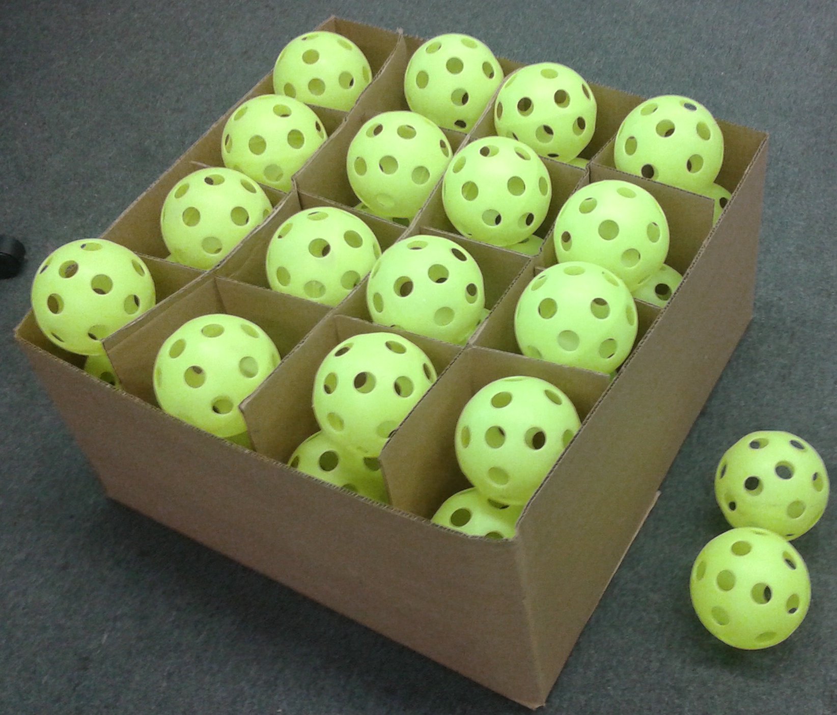

I noticed over several webcasts this past weekend that field reset for fuel typically consisted of hand-counting 50 fuel and placing them into each hopper. While this works, I thought it may be worth looking into a more efficient way to help reduce field reset time, so I modeled this quick and easy hopper reset box.
The idea is pretty simple - the box is dimensioned such that two levels of fuel arranged in a 5x5 square fit snuggly into the container, holding a total of 50 fuel cells that can be quickly and easily counted. As long as field reset arranges the fuel such that they sit neatly, they know for sure that 50 fuel are in the box, and can dump that batch into a hopper. I think it’ll be faster than counting by hand, and less prone to mistakes.

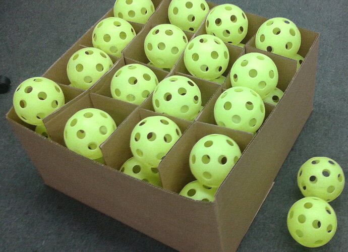

At the NC District Event this past weekend (Pitt County), they had boxes in a similar dimension as what you show with dividers, breaking the box up into 25 compartments. Then, 2 balls were stacked into each compartment. Looked like too-tall, too-wide wine box.
At the Peachtree District qualifier in Gainesville this past weekend, we used a set of tall square tube boxes from our friends at Automation Direct. The standard box is like this box from Uline . They were assembled individually with the bottom sealed and then grouped into a 2x3 configuration of boxes. The flaps around the outside were taped together and the flaps on the insides were removed. This means you have a tall box with a tall egg crate inside. Dump balls into that and they self sort into the tubes yielding 48 balls. Add two to the top and dump into the hopper - 50 balls exactly every time.
Collect the balls however you want into totes without counting them, then dump them into the counter and they will assemble into the tubes without jamming. We also use the boxes to transport the balls from event to event.
I think if you try to use a box with no interior dividers, the balls will not self assemble as you’ve shown, but instead alternating layers will nest with one less ball in both dimensions. so that second layer will be 4x4 instead of 5x5.

The Durham event in Ontario had boxes divided into 5x5 sections tall enough for 2 balls each. They seemed to save a lot of time for the field reset crew. It showed as well with that event being only 1 hour behind at the most and that was caused by a couple of issues with a touchpad on the airship. The field reset crew was even able to make up some of that lost time.

I picked up some boxes from my local plotter supplier, 24" x 24" x 24". One box makes 2 Fuel Resetter Boxes, plus cutting up another box to make the dividers. Not quite the right size for a 4 x 4 x 3 high (plus 2 extra), but what do you want for free?

This is exactly why I have put together boxes 20.5" x 20.5" x 13.5" out of corrugated plastic. 4 layers of balls, 16+9+16+9=50 and they arrange that way pretty much on their own when dumped in. As a bonus they can easily dump into the hopper without much finessing and are very light. I prototyped first with 3/16" plywood and although still light, after 3 days of hauling them around I was thinking my field reset people would mutiny.
