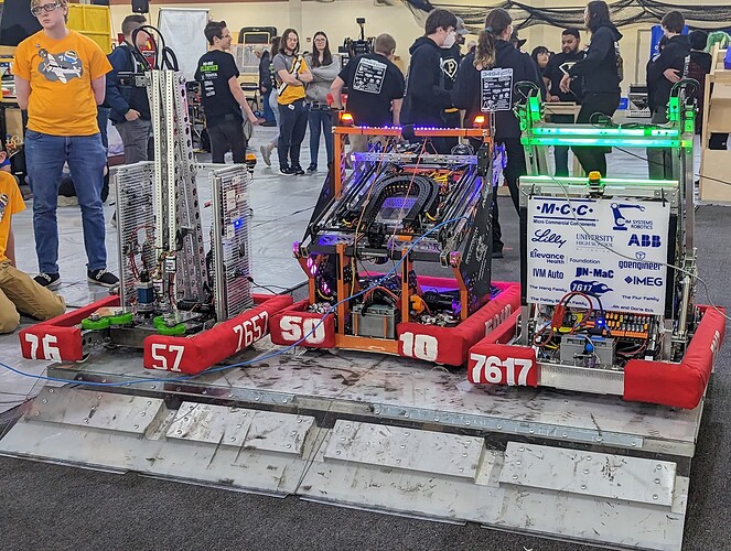

I just wanted to publicly highlight this bit of clairvoyance. A 5010 mentor called out the two teams they selected to win INCMP.
Actually, we’re really grateful to 7617 for picking US and for 7657 for being such a solid third. Like Ryan said, it was such a close and tight path to victory. Getting disabled in match 10 when our bumpers jarred out of the bumper zone and fortunate to get on the charge station while our partners finished out the match and nailed the triple without us was a nail biter! We could have also so easily lost to Alliance 7 a second time (292, 3494 & 5188) but for a last second cone dropped in low by 7657. Alliance 7 could have won it all, too, they were formidable! So many teams in the top 16 could be listed on the ‘deserved to make it to worlds’ thread.
Just some other notes about what I thought was a cool alliance -
  • Both of our partners were running the Andymark kit drive. We were the only swerve on the alliance. The rumors of tank drive’s death are exaggerated in my opinion. 7617 and 7657’s drivers were consistently smooth and drove well.
  • Both 7617 and 7657 can pick up pieces from the floor, with 7617 especially being good at that. You’ll notice in matches how well they cleared the center first, reducing their cycle times and leaving the lane wide open for us to make runs to the feeder. Not having all 3 robots constantly clogging the loading area was really key.
  • Both 7617 and 7657 were fairly small bots. 5010’s bot this year is about as big as you can make one. Having 2 / 3 robots undersized made the triple balance pretty easy. We went to the practice field and immediately did it multiple times, so we knew we could push that last cycle fairly late and still be okay.
  • 7657 was the 3rd to last robot picked and had a solid 2 piece high auto. I’m not sure if everyone else just missed that, but wow were we glad they were still around. 5 pieces hitting in auto towards the end really helped.
  • Every single person behind the glass including coaches were students in this alliance. A credit to the drive coaches especially for remaining calm and cool and working through the strategy sessions together after each match.
Really couldn’t have been more proud of the alliance and the team this weekend. 5010 spent about every possible hour for the last few weeks, including spring break, to completely make a new arm, dial in autonomous routines and get more driver practice. A lot of late nights that paid off in the end.
