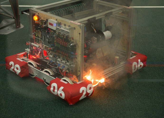

Can anyone fill in the details of the fire that happened at PNW?

http://i.imgur.com/e08gHgQ.jpg
From the photo and video clip it seems like wire insulation is on fire and may not be the battery. This might be due to over heating and poor insulation. PDP was on, hope there is a log of current usage on their driver station. Hope LRI can post details of their analysis.

So I heard that that that battery came lose and experienced an inpact on the terminal forcing it inside the battery. This caused a dead short inside the battery and as such most of the fire was contained inside the battery. I hear that none of the other electronics were damaged but a carbon fiber panel delaminated which is being replaced with polly carb and there was some charing on the AL frame. As well as some dry cem got into the gearbox but they should be back on the field today.
The battery was placed in the robot upside down. During the match the negative lead of the battery was compressed into the battery, causing a short inside the battery itself.
The robot itself did not suffer damage due to the quickness of the field staff. Make sure you know where the fire extinguisher it.
The robot was cleaned out, taken apart, put back together, reinspected and sent back to the field.

One issue I see here that hasn’t been brought up is the use of an ABC fire extinguisher. This really is not the right tool for the job. A C02 fire extinguisher would be much more appropriate. There’s a few applicable sayings:

If there was a dead short the robot would have immediately shut off, That robot is still hot and live! It was not a dead short but whatever it was is very nasty business. I am very surprised that the bumpers did not go up with the robot though.
I am still waiting on the full report but prelims have pointed at the carbon fiber belly pan as being the conductive agent in starting the damage. More info will arrive later.
