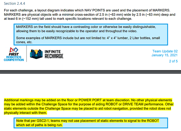

From team update 2:
In fact, if you wanted to, you could create your own custom vision targets with retroreflective tape anywhere you wanted them. You could lay down a path line on the floor and use line following for all your autonomous tasks. Or for keeping your robot on the center line of the field for the shooting tasks.
The team updates and the QA responses have changed the nature of the competition quite a lot since kickoff day. If you (global, not specific) haven’t read through the manual, the team updates, and all the QA responses lately, you are leaving yourself at a competitive disadvantage.

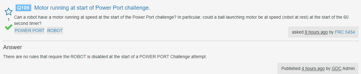

And the GDC just made it even more interesting.
I don’t know what the GDC is thinking with this answer, but oh, well. Now we have to live by it.
In fact, for the Power Port challenge, there is no rule defining when the timer needs to start. We had been starting our timer when the robot is enabled, but this clearly is incorrect. If we don’t start the timer until the robot begins driving, we can begin the 60 second period with the first 3 balls already scored. Sweet.
I guess per “The raw score is the total number of points scored within the 1-minute period.” that period could be right before the first ball enters the goal.
I completely agree that this ruling is insane. You can’t say “use common sense” and offer guidance of using test mode as how to run the challenge and then make a ruling like this that completely goes against all common sense!
