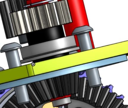

To answer your questions:
  • I didn’t notice there were only 4 on each side of the contact bearing, more can definitely be added.
  • I tried to reduce the backlash by putting a bit of tolerance into it, one of my mentors told me to always include 2 thousandths tolerance for gears. (this may also become printed for the encoder gears to lighten the overall weight.
  • The bevel gear has a bearing right inside the fork, and the other is in the 72 tooth gear. (photo below)
  • The pinion on the motor is a 14 tooth. currently, the setup is 14:24 then 15:60 giving a ratio of 6.86 and an estimated speed of 12.39 (free speed of 14.45) I know with the 14 tooth gear it makes it the top plate needs to be attached to the neo before adding the gear, but it was one of the only ways to get a speed that was desired. Wouldn’t be easy to do an Aren hole and using a smaller gear after the pinion would have moved the wheel more offset causing more issues with mounting holes.
  • The bottom and tops plates are designed that you just flip them both 180 then assemble them to get the other two corners made. so currently this image would be the front left and back right. If you flip both plates then assemble you have front right and back left. We used this same idea this year on 5030 with our drive gearboxes as we had 1 in each corner and it worked well. It is just a point of marking which side is which when you build it to avoid a problem.

6
This clearance actually increases backlash but helps to minimize grinding and jams caused by imperfections and tolerance stacks.
Noted.
So Is it better to have the tolerance?
2 thousandths is a good clearance for a normal FRC geartrain. In this case, you want minimal backlash for a low load encoder, so I would probably be comfortable taking it down to +0.001" or even 0.
I’m sure someone give you a magnitude for the difference in backlash; it’s probably negligible.
