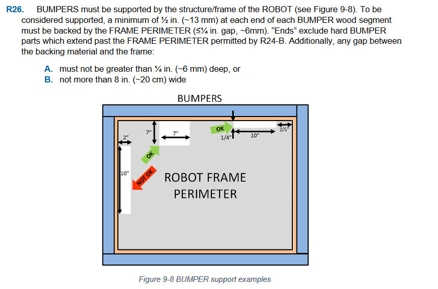

Does that violate R26 or not?
Take the “bottom left” corner for example:
Before the corner on the left, it’s supported by the bumper rail.
After the corner on the bottom, it’s supported by the bumper rail, then the angled 3x1, then the frame rail.
You don’t even need it to be supported by the angled 3x1, since the 1x1 bumper rail supports the bumper for more than 1/4" on the corner.
TLDR: Yes, it’s legal.

That’s true. You could get rid of the front rail completely, depending on how your bumper attaches. The front bumper (or part of bumper) can attach directly to the front beam of the chassis.
Thank you for the advice, I appreciate it!
One thing I am concerned about is that the bumper rail itself is only strong in one direction if I do that, is that something I should be worried about or not?
If you’re worried about strength, think about what happens when you get hit:
When you get hit from the front, the impact will go through your bumpers and into your frame. The weakest link here is probably the bumpers themselves.
When you get hit from the side, the impact will go through your bumpers, through the bumper rail, though the bumper rail supports, and into your frame. In this case, the weakest link is probably the bumper rail supports.
Assuming you want to increase strength, you should focus on strengthening your bumper rail supports. In this case, what’s really weakening them is that angle cut. If you take away that cut, at least on the bottom, it’ll be a lot harder to bend it from an impact.
