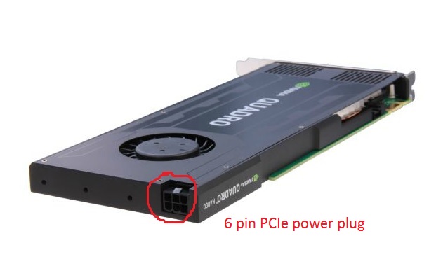

Anybody know what type and where to purchase the power cords needed for the Video Cards that came out in First Choice? Doing a little reading says it needs power to two places. Thanks.

You need one standard 6 pin PCIe power cable. Most modern computer power supplies should have at least one.
This could burn out you motherboard under heavy load. The 6 pin PCIe power plug is on the back of the card.

The card we received has no auxiliary power input, the only additional connector is the SLI bridge. You’ve also linked the wrong card. The K model is a newer generation than the one on FIRST choice.
Are you sure? It’s listed as the K4000 on the FIRST Choice website and both have identical specs. They both list the power draw as 80W.
Edit: Also, on the product page for the card linked by cadandcookies above, it says that the package contents include an auxiliary power cord and I don’t see any reason why AndyMark/FIRST would remove it from the package and ship only the card itself. If that actually is the case, you should probably buy the cord by itself.
Sorry my mistake it is a K series. Still the card we received appears to be a different variant of K4000 card (maybe a OEM version) than even the one of FIRST choice and does not have an auxiliary hook up.
As far as I know, all K4000s have a 6 pin power plug on the back. See the attached picture.

This is a different model than the FIRST Choice one. In that one, only part of the circuit board is covered by the black box.
That’s not what came in FIRST Choice.
These are what came;
Well the one we were given does not. Can anyone else confirm with their FIRST choice cards?
Sorry, I did not realize that there was this model. Every image that I have found was of the variant that I linked to, including FIRST Choice and nVidia’s product page.
Oh that’s funny, I didn’t realize the AM page had the wrong pic.
