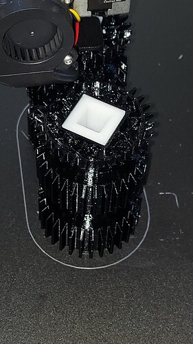

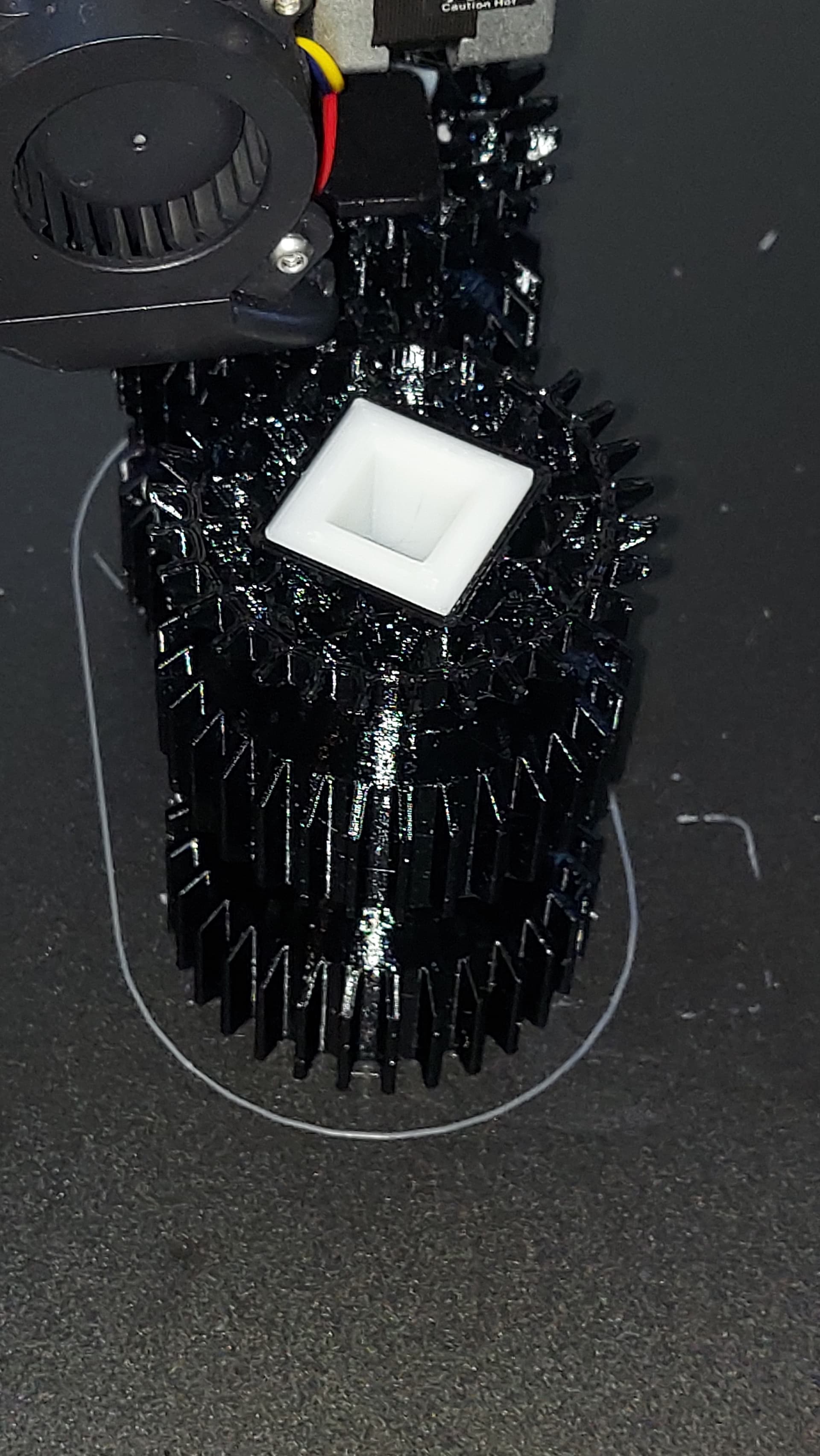

Well I got myself a SOVOL SV04 printer (IDEX) and as a test we decided to print the take in rollers for the off season competition. It will be driven by 1/2 in square aluminum shafts connected to belt/gears and motor and the hubs are HIPS or PETG and the “tire” is TPU
This is during the print to give a view on the inside. The “squish”/ give of the "tire is controlled with the infill and the hub is 100% infill and square so no chance for the tire to slip and there are extra “fingers” as a profile

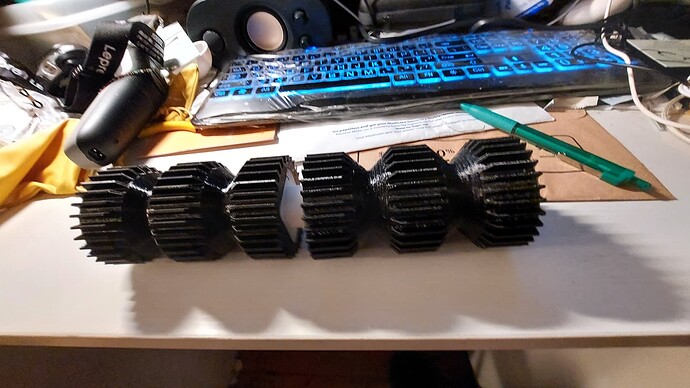

This is a side view of 2 of them together about 10 in long.2 of those should do the cone and/or the cube.

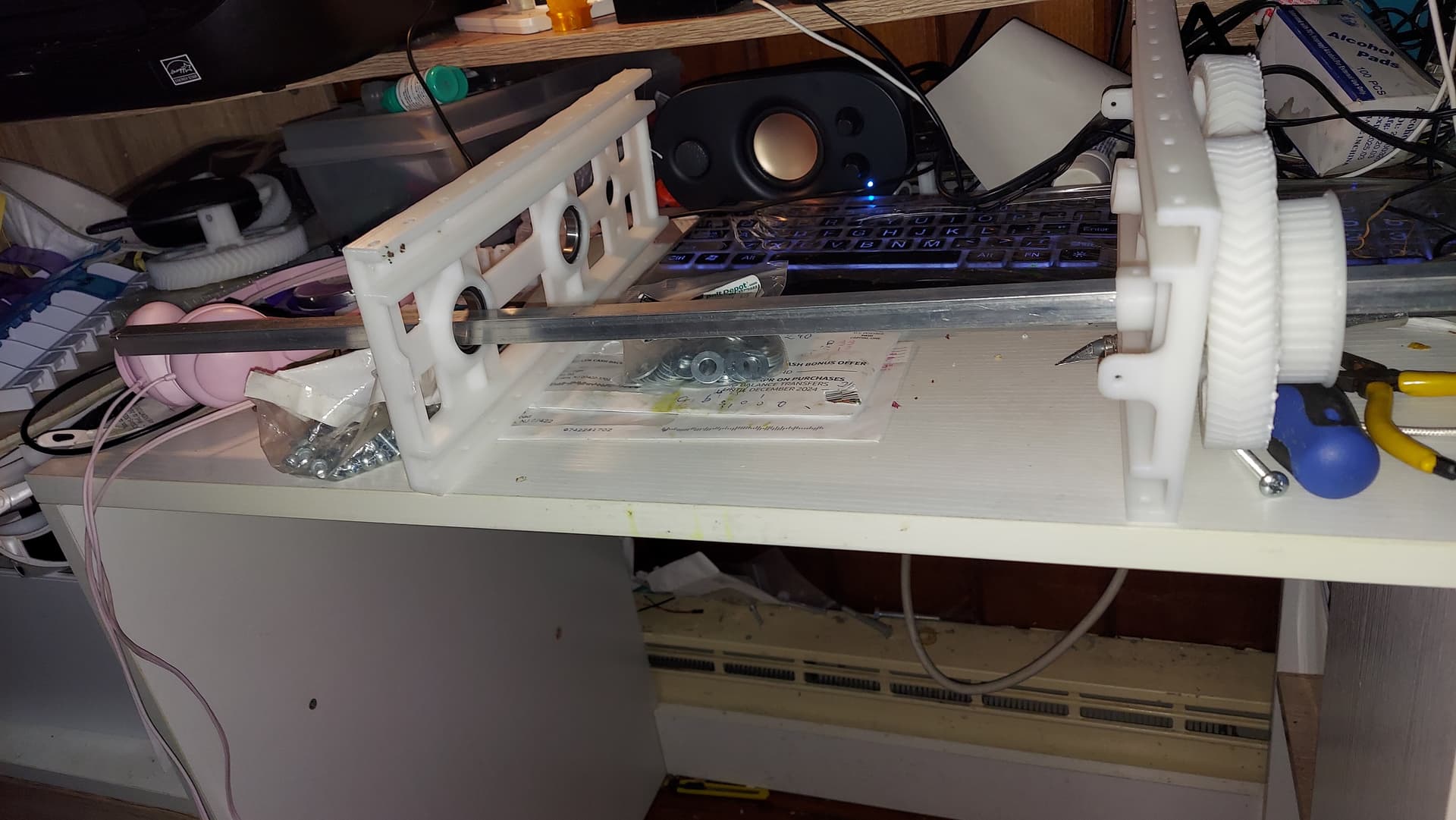

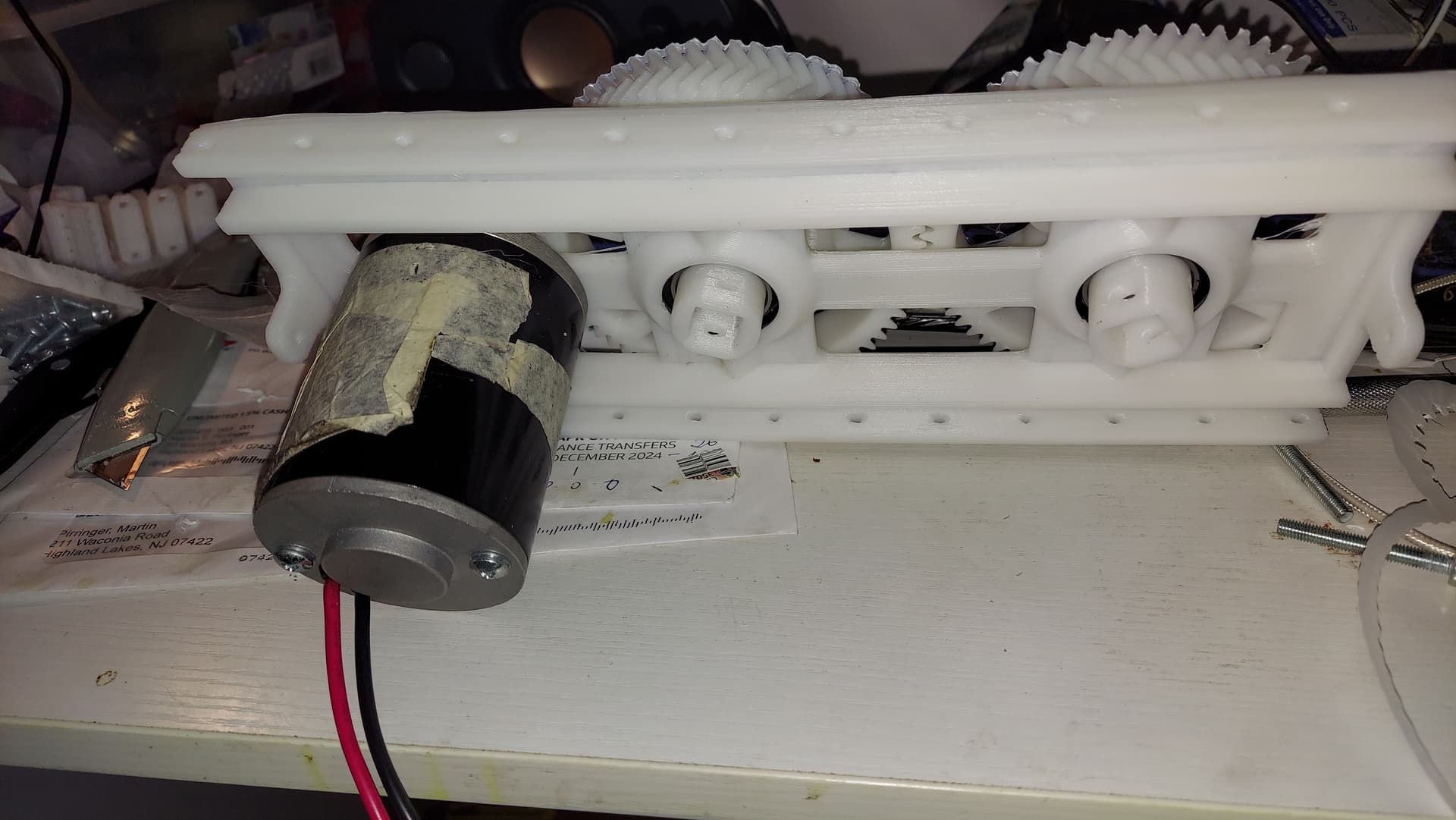

Just for completeness sake that this part of the mechanism that will be strung together with 1/2in square al. tubing

SV04 is an IDEX (Individual dual extruder) machine and I bought it new for 429 incl shipping and tax. I use prusaslicer with it. So the left extruder has one filament in my case PETG or HIPS and the right one has the other - in this case TPU. You do the cad. I use either inventor or F360 and you create 2 bodies 1 for the hub and one for the tire and make sure they match - you can generate the geometries from the other body and then expand on it. Then you load both stls (inventor) into prusa slicer or in case of F360 I prefer to export as a 3mf. And then you assign the extruders and set the slicing parameters
So for example in the above case with HIPS it was for the left extruder 250C, 6 perimeters 100% infill and for The right one (TPU) 240 C 3 perimeters 5% 3d hex infill (10% initially with 4 perimeters which made it imo a bit to hard)

I’m more curious how do you get the HIPS and TPU to bound together? Looking at the photo (only the 1st one shows the HIPS center and TPU black outside) it doesn’t tell if there are any bounded interface layers (I’m interested to see how strong this bound would be if it exists). Or if it’s internally locked by some sort of mechanism or special shaped parts.
The bond between the material is rather weak. Hence the hub is square and that makes a good mechanical interface on each end it steps up 5mm so even if there is a lot of lateral force it cant slip off. 3 perimeters of tpu (.44 + .63 + .63) perimeter width gives 2mm of TPU which at this TPU (Zyltech.com) wont stretch enough to skip. Even though tpu sticks ok to quite a few materials I would not trust that alone. In this case I know it will work as I did prior 2 part hubs like on this
A prior year shooter that was printed in pieces and then the hub halves held together with fasteners on the square axle. Now the IDEX option offers a way to make smaller hub/tire assy as you do not leave room for fasteners. On the 2 piece hubs I had to allow .4mm clearance between the hub and the TPU to assemble it without the use of a hammer. In the IDEX version I have 0mm clearance so even tighter. At the 2 piece hub with the .4 mm clearance the “grip” was quite sufficient so with the 0mm clearance it should be even better no matter how much it adheres or not.
Nylon wont stick to anything except Nylon so the mechanical interface will do all the lifting. Petg for example sticks very poorly to HIPS or ABS so it makes a great material as support or vice versa as it comes off nicely.

They are printed “kinda” at the same time as you can see in the picture that is taken while printing. In normal printing you got 1 print head and that one gets the G-code commands - generated by the slicer - 1 layer at a time. That is how FDM printing works. With an IDEX printer in dual mode you have extruder 1 lay down layer 1 for filament 1 then it goes and “parks” and extruder 2 lays down layer 1 for filament 2 - then it parks and extruder 1 lays down its next layer and so on.
When you design stuff and slice you can design things like what each extruder prints. You can have extruder 2 for support material and extruder 1 for the part in which case you want the 2 materials close but not stick too much. You can also have 2 parts that are designed to intermesh somehow and assign extruder 1 to part 1 and extruder 2 to part 2 etc. in the hub/tire example that is the case

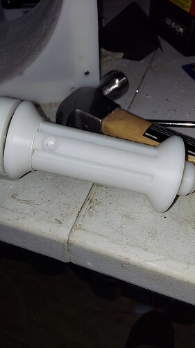

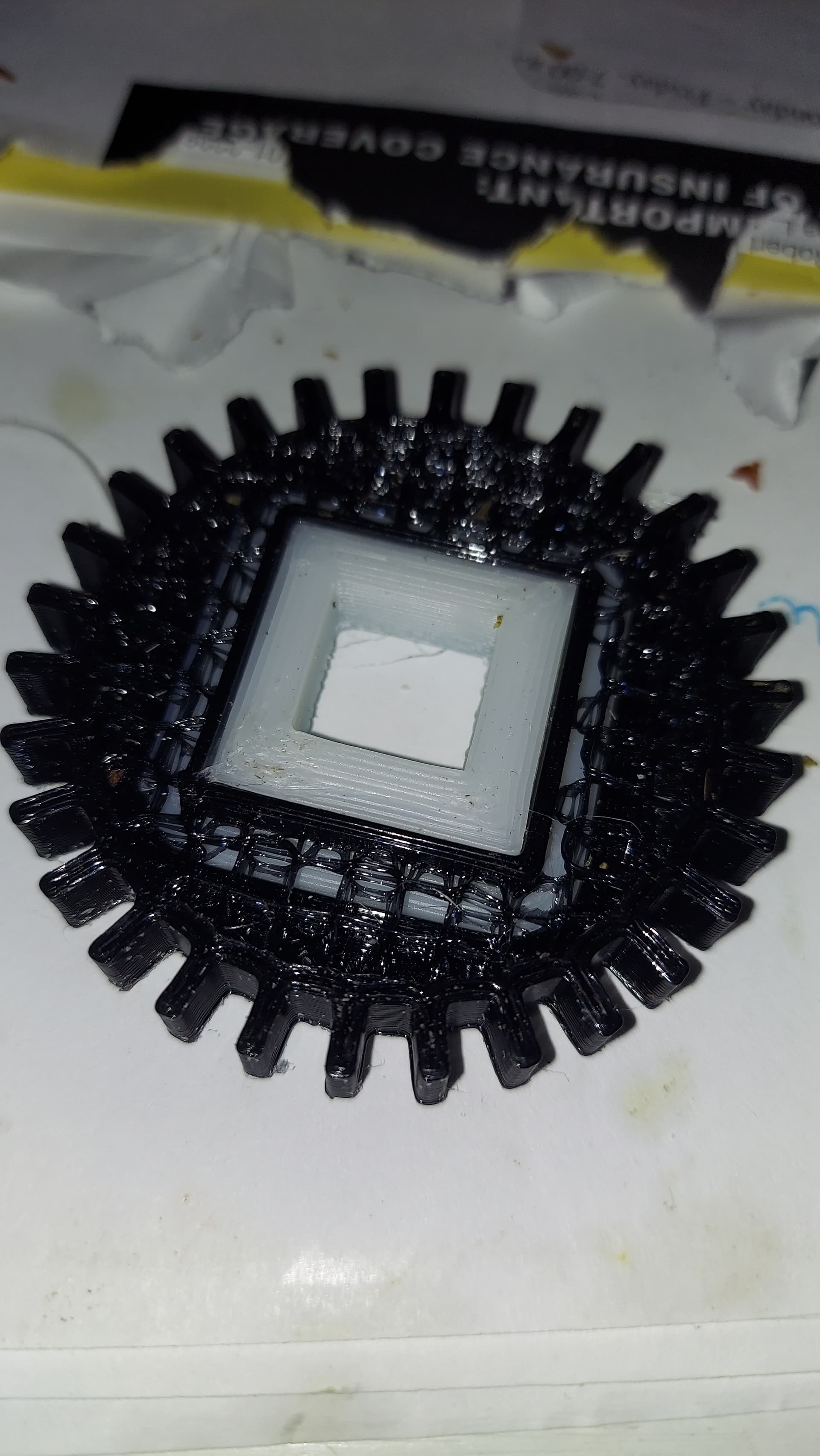

Here is a short piece of the Hub ( I started the print and then stopped it and tore it apart) you can still see a little TPU stuck on it

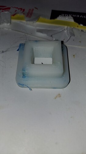

Here is another one of those interrupted test prints from the top
This is about 10mm up so past the 5mm step you see at the cleaned up piece. The step is on both the bottom and top to keep the tire from sliding off. So its sandwiched between the endes of the petg or hips hub. And the square shape of the hub makes it not slip when rotating. You of course can make it round and put other indentions in to make it not slip like a profile on the inside
